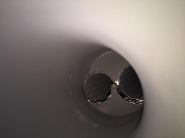

I have had a rattle from the passenger side for about the last 3 years now. Today I had total failure the batting shot out of my passenger side pipe. It is hard to believe it has been 9 years since I had it built which would place the car in the older older version. What are the suggestions to fixing this $1.6k seems steep and on back order is rough. Has anyone just removed the packing and called it a day? Other than veryloud what else is the drawback? I do like the idea that the new pipes give less restriction to the motor.

Looks like sh*t Welds. Where would one drive a screw. Tigging in their would be blind and difficult.
The Caveat is that the driver side doesn't even make a squeak.
Any one in AZ know a good Exhaust/Stainless guy?

Default picture of the new pipe
Can anyone post a pic of what the new less restrictive pipe interior looks like?
Much Appreciate.

An alternative to consider is to cut off the old sidepipes after the collector, and just after the pipe flares from 3 to 4 inches, get a spiral insert (Spiral Turbo Specialties) and a new 4 inch aft pipe section (in my case, from Stainless Specialties), cut the spiral insert to length (drill and tap holes as required to attach the spiral insert to the new aft pipe), have someone weld on the flanges for a v-band clamp, and voila! I did this not because of rattling but because I was tired of the sound of the original mufflers on my old beastie. I'll post pictures in a few minutes, once I find and reduce 'em.
Bill
