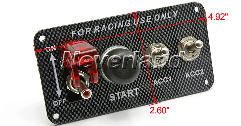

Originally Posted by rbgray1
Redhawk,
My Flaming river column is gorgeous, I ordered a polished, tilt, with no key...going to install an ignition switch with a key on the dash when I rebuild the dash. Probably also going to install a momentary "starter" rubber coated button for the start function.
Something like this?
Brian
10-14-2016, 04:28 PM
Take your protein pills and put your helmet on
Ground Control to Major Tom (ten, nine, eight, seven, six)
Cycleguy where do you get a hold of one of those?!
Aliexpress - $27 direct from China (where most of the stuff we buy is made anyway). Shipping time is usually 3-6 weeks for other stuff I've ordered, but I have no personal experience with this panel.
https://www.aliexpress.com/item/Hot-...8-37404745bb9e
Brian
