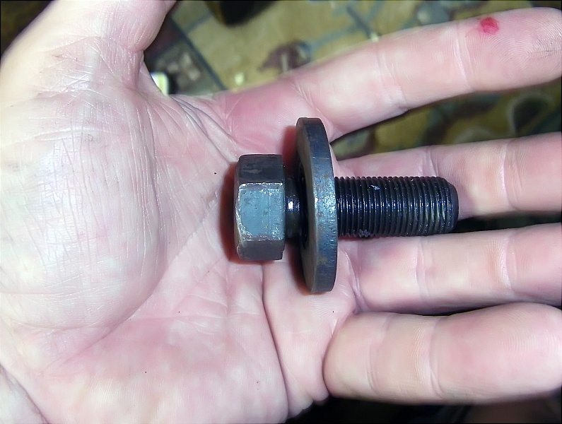

Pulling the crank bolt -- this is a "French Curl Bar" that I use on the end of a breaker bar that has a 15/16" deep dish socket. Supposedly the bolt is torqued to something like 90 ft/lbs -- it comes off pretty easily though with the weight lifting bar on it. Here are two shots:
Crankshaft Bolt is out -- no thread lock on it, btw.
Three pulley bolts are now easily removed -- no thread lock on them either. I didn't bother loosening the alternator either since the pulley easily comes straight off.
My "two piece" dampner does not pull off, and I'm not going to pry it, whack it, etc. I'll pick up the puller/installer tool this week.
Here's a shot of the pulley -- I can't tell whether the holes have been worked on or not. I'll see when the new dampner comes.
That's as far as I can go today. BTW, thoughts on using thread locker on the crank bolt and/or pulley bolts?

Use the ARP spec that comes with the bolt. Don't remember but I think mine was 105-115 lbft. Yours should not break so easily-you were lucky.

That curl bar is 34" long -- I can put a heck of a lot of torque down on the end of a three foot long pole.  But if I had to swear to you, I don't think I put down more than enough to break loose maybe a 50 ft/lb bolt, if that. But it's really hard to tell when you have that much leverage, so it could well have been in the 70-90 range.

I could see how you could make the crank bolt fail in a Chevy.....but not a Ford engine. All Ford crank bolts are 5/8" diameter. That's one thing I could never understand about the Chevy junk.....fasteners were all the size of pencils.
She's a pretty serious bolt. Looks and feels brand new. I'm tempted to skip buying a new one.
