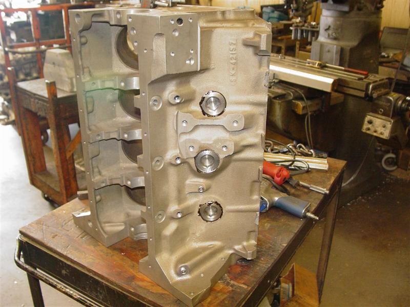

Now that I have your attention. I have been working on Jim Dove for almost 5 years to make a SOHC kit. I finally got through. I spoke with Jim on Monday, it looks like the cammer kits will be a go. Jim was looking for 10 people to each buy 10 kits. The large run is what is responsible for the low price. Maybe better news is that I have been working hard to line up a consultant to help in the foundry. More details on this, but hopefully this will help with the casting quality. If you are in a rush, Jim says he can have kits in about 90 days, the whole production run will take much longer so purchase timing is flexible. Some details on the kit:

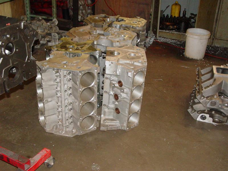

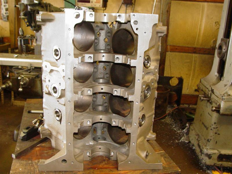

Block

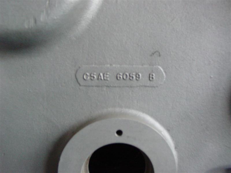

This block is based on the Ford Lemans aluminum block. It externally is identical to the Ford piece. The main webs are much thicker, and so are the decks. This is going to be a dedicated SOHC block. The lifter bores and the rest of the cam tunnel will not be machined. The standard bore will be 4.25 with a max bore of 4.31. The main saddle bores will be finished to factory minimum, and the oil drain back holes will be drilled. It will come with main studs and crossbolts. The bores will need to be finish honed.

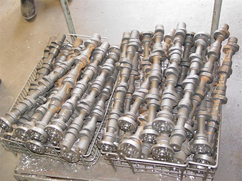

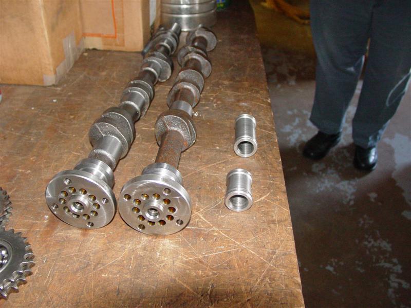

The rockers offered currently ar very beefy iron pieces, but may be changed to aluminum in the future. They are very nice pieces, with the correct crown on the rollers. You will get cast cam blanks, ready to be finish ground to your specs. Crane has over 20 profiles to choose from, plus other companies also offer grinding services for the SOHC cams. A cast, fully finished snub cam will also be included, along with the rocker shafts, spacers , and cam bearings.

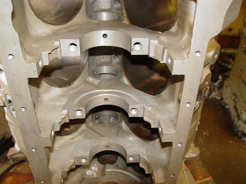

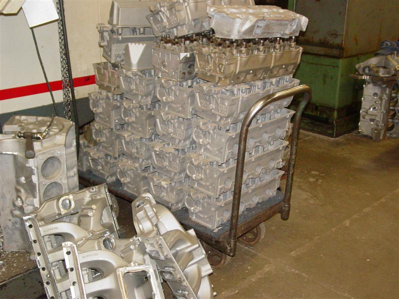

I was just at Dove's factory last weekend, picking up an intake. Things are progressing quite well. Jim had a rep in to help with the casting. They changed the bonding agent, glue, in the sand for the molds. They had raised the temperature of the aluminum to try to get it to fill the molds better, this caused the bondng agent to break down and contaminate the the castings. The rep also suggested changing some of the gateing on the molds. Gateing is where you pour the molten aluminum into the molds, and also were gases are vented. These changes have the molds filling better, and they have since been able to lower the temp of the aluminum. The rough castings are looking much better, they are working on sectioning a few to see how they look. I have some pictures, if someone could post them for me. I still haven't figured out an easy way to do it here.

Here's your first batch of pictures, Paul...

More...

...and more
