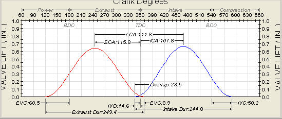

I am hoping someone can help me figure out what this information is that I received with my Cam.
I would like to find out if this is a good cam or if I should think about tossing it and installing a new one. Also the second document below what could this be?
Intake
Lobe Separation = 111.9
Valve overlap= 23.4
Valve open 14.6
Center line= 115.8
Valve close= 50.2
Duration: 244.37
Lobe Lift= .65956
Lobe area 30.85
Exhaust
Valve open = 60.5
Centerline = 115.8
Valve Close = 8.9
Duration 249.3
Lobe lift .3789
lobe Area 31.83
Second document
Intake 245 @.050
Exhaust 250 @.050
.650 Lift
Compression 9.5
Intake Exhaust
.200 150.4 114.3
.300 206.5 151.5
.400 256.6 179.2
.500 292 195
.600 306 208
.700 312 320
