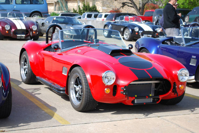

Vector....in any case I am glad to see a proper hood scoop on the track dog. Looks much better than the one made from cutting the top out of Darth Vaders helmet.

Update....well it is not on the road yet....but I do have it home finally. Still need to work on position of the side pipes (now that the body is on they are too close, cover and re-install dash etc.

Well about a month ago I got it finished. Got it about sorted out now. Just needs carpet and trunk finished.
