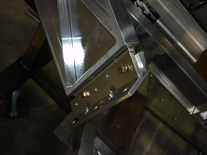

Here is a shot of a dual use bracket. This bracket holds the gas tank straps on the bottom and the 3/4 body tubes on the top.

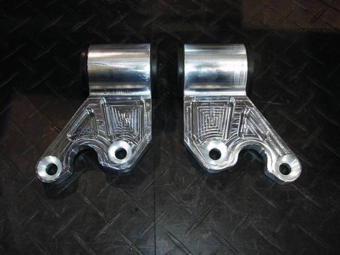

This is a pic of the rear differential upper mounts. We are using the same differential we use in our own cars, original Cobras, and Shelbys.
