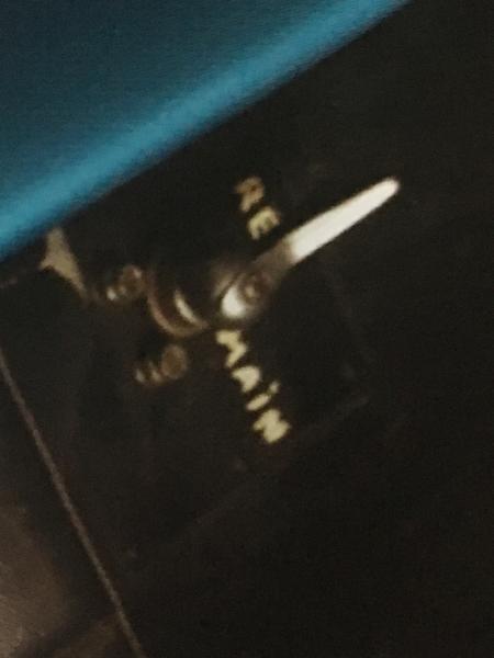

Could anyone please provide me a detail picture of the Imperial Fuel Switch installed on CSX2431?
I’m interested on how it got labeled (it seems to me there is something written beside the switching positions) as this cannot be seen on the pictures available on the internet.

Looks like from the photos:
The position of REV was moved
The painted REV was wiped off, except part of the R
The MAIN decal was placed over painted MAiN

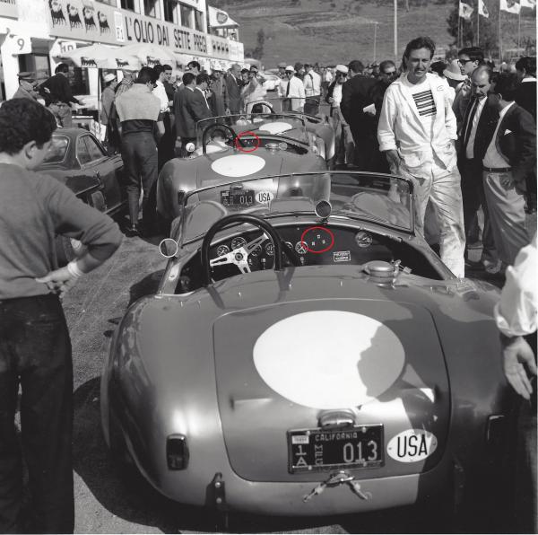

FIA team 289 Cobra CSX2323 at the Nurburgring in 1964 just before it was wrecked......
The letters on the dash within the green box are for the fuel selector valve, "O" OFF, "M" MAIN and "R" RESERVE. There are other in period photos of other team Cobras that will show the same type of lettering but with the letters in different positions depending on how the mechanic building the race Cobra clocked the valve, there will be variances from car to car. There are also variances in locations, Miles had the selector valve diagram on the transmission tunnel behind the shifter on his Cobra where most of the FIA Cobras had them front and center on the dash.

Now I understand what they have signed on the dash
It would help some times if I would search for details on the pictures I've on paper and not only on the PC....

It would be much safer for the drivers to have the fuel lever selector positions up on the dash, the less time the drivers took their eyes off the road the better!
On another note Armado's photo shows the padlocked fuel cap and the Smiths Chronometric tachometer that were also used on the FIA Cobras (green circles).

Hi John
You're right.
There is a Padlock on the gas cap using the same part you did provide to me.
After some investigation I diendtified the Padlock as a Slaymaker and I was able to find one

Just fyi, the legends in the first photos posted are not decals - they are Dymo labels. 'Dymo' was a hand-held stamping machine that reverse-embossed a strip of coloured sticky plastic tape for home labelling purposes. It was very common for every use in the UK in the sixties, and was very often seen on racing car parts.

SAI tended to use, paint, DYMO labels or industrial decals to label their racing Cobras. Earlier race Cobras tended to use a mix of the first two methods and later FIA Cobras tended to receive the decals. I believe the markings at the selector valves was possibly done for the mechanics servicing the cars.
