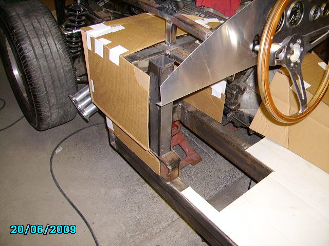

Another update, now have my pedal assembly(wilwood), unisteer rack, and sidepipes, and am making up cardboard templates for the trans tunnel, and footbox areas. I am thinking of putting a lifting system under the pass seat so the wife can get in and out easier.http://www.clubcobra.com/photopost/d..._Build_095.jpg http://www.clubcobra.com/photopost/d..._Build_094.jpg
