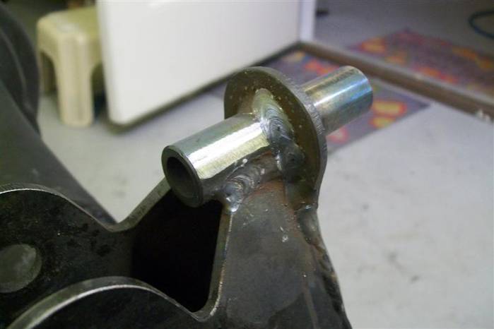

Jerry, actually no. The area I welded was way on the end of the existing bracket, about 4" away from the tube. I think what happened is when I first got the car the metal guy for B&B welded the brackets for the four link way off so it had about 3 deg. negative pinion angle, pointing down. They took the axle back and cut everything off and redid all the brackets. When I got it back one axle would not slid in without force. I called them and told them about it. I should have just sent it back then. Monday I will call Currie and Strange and see what they say.
The area I welded.

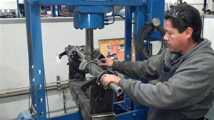

I just wanted to do an update on my 9" B&B housing that was toed in. I shipped the housing to Currie Enterprises in Calif. to be straightened. Currie Enterprises - Custom Rearends, Jeep/Off-road Parts, Crate Rearends, 4x4 Rearends
I got a call today from Tom at Currie, and they were able to straighten my housing. Yea !!!! . I don't have the total cost yet but I will update this post when I get it.
Tom, from Currie sent me a picture of my housing in their press.
