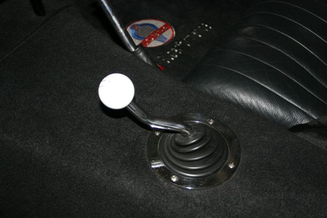

Rob, I took a quick pic of the shifter this evening:
I added a white Hurst nostalgia looking ball handle to go with the white stripes on red car. Underneath the boot is the Pro 5.0 billet shifting mechanism. Encouraging to hear from others that the TKO 600 has a superior mechanism!
Here's a good shot on how the Jordan shifter lever differs from a stock looking (original) shifter:
-Dean
