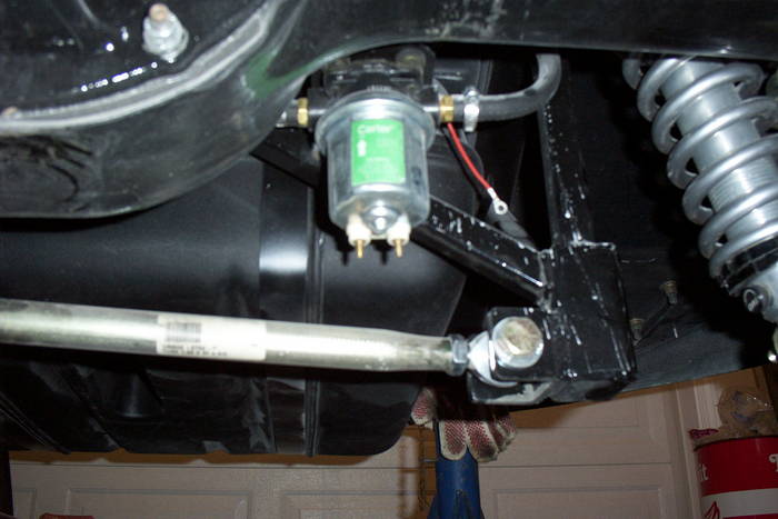

Size:  33.1 KBHere's what I did. Used a Summit pump, that I believe is a Holley Black, private labeled for Summit.
http://store.summitracing.com/partde...5&autoview=sku
