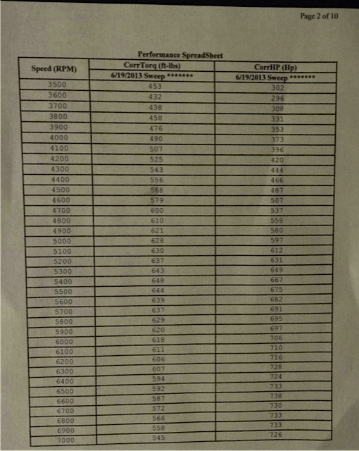

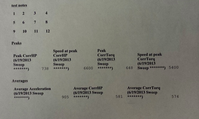

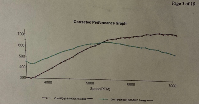

Dyno day finally came, but not without problems. The center cylinder’s (2,4,6,7) would pulse and spark, but the outside cylinders would not. The computer was showing the rpms during cranking ranging from 0 to 12000! After retracing wires, rechecking grounds, ½ the problem was found (cam and crank signals reversed in DFI harness from the factory). I reversed the pins, but the cam signal was still not working correctly so we switched to bank to bank. It had taken all day to resolve the problems. Time was running out. It was now 5PM and we had not started the engine. Moment of truth “Fuel pump on and a push of the start switch”. The engine fired off and idled at 750RPM. Idle was adjusted to 1100 and couple small leaks (loose AN fittings)fixed, and some quick timing adjustments and we are off to the races. Break in was uneventful and no metal found in the oil filter.
First pull would be from 3500 to 6500. Some adjustments were made to air fuel ratio, timing, and another pull to 6500. Still running lean in 4000 to 5500 range so more adjustments made and another couple of pulls to 6500. Timing was set to 32 degrees. Next pull was to 7000 and dyno read 741HP at 6600 and TQ 633 at 5400! Timing was adjusted to 34 degrees and another pull to 7000. The engine liked the extra timing, yielding an Averaged hp of 581 and 574 TQ. Max HP was 738 and max TQ 648. Out of time and well pleased with the results we called it a day. I discovered after I got home that we had forgotten to adjust the timing above 6500 prior to our 7000 rpm pulls. With more time I am sure we could have squeaked out 750HP.
Important Notes:
Engine was dynoed with following: Alternator, engine driven water pump (overdriven), Cobra headers, 93 octane, Break in oil, Vacuum relief set at 10”
Compression 11:1
My headers were used during the dyno session
Precision Race Engines preformed engine dynoing.

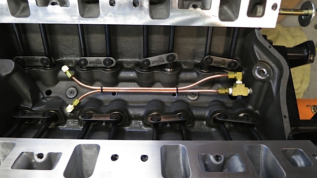

I am especially impressed with the changes made to improve oiling to the lifters. I was under the impression that the Dart block did not need these changes.
What is the reason for the bronze bushings for the lifters? Longevity? Reduced friction?

We do the bronze bushings sometimes when the lifters are really tall. Under high lift with high spring pressure, the lifters will want to "wiggle". One, it's easier to R&R a bronze bushing. Once cast iron is oblonged, then the only choice is to....well....put a bronze bushing in it. Another reason is that we can leave the bushing sticking up out of the lifter bore some, so that gives added stability at full lift.

Bob I agree with Brent, but i would add that it does reduce friction (dissimilar metals) and it gives u an opportunity to verify and correct bore alignment. I went with a .903 vs .875 lifter so adding bushings was not a problem.
The SHP or sportsman block does not have rear oil feed, so oil travels from the front to back, therefore; the rear lifters are fed first. By tapping in from the rear and plumbing to the front a more balanced stream of oil is provided to the forward lifters. I am sure Jim could add to this.
The SHP or sportsman block does not have rear oil feed, so oil travels from the front to back, therefore; the rear lifters are feed first. By tapping in from the rear and plumbing to the front a more balanced stream of oil is provided to the forward lifters. I am sure Jim could add to this.
MP
Very interesting. Next time I do a major overhaul, maybe I'll do that. I don't have any lifter problems, and I don't seem to have any problems with oiling. But I don't really want to wait until I do have a problem. That looks like a simple enough mod to do in the garage.
I'm still considering dropping solid roller lifters on my hydraulic roller cam. So maybe I'll have the machine shop put in some bronze bushings.
Thanx for sharing that with me/us.

You don't need it Bob, and it's a lot of expense to do it correctly. You can't just drill the hole and press a bushing in, it needs to be done with the block and a BHJ lifter fixture for it to be done right. Most hydraulic roller cams do not have the lift nor do they require the spring pressure to need anything near this kind of prevention, and you won't see any horsepower increases because of the bushings.
As for a solid lifter on a hydraulic roller, be aware of what's necessary here....you still need to run lash, and you will need to run a very tight cold lash, because hot lash needs to be in the .006-.010" range. Even then you still have lash, which coupled with higher valve spring pressures is what kills a solid roller lifter over time. There are many short travel hydraulic roller lifters out there from Comp or Morel, where you can adjust them and run high spring pressures and get more potential rpm out of your combo.

You don't need the bushings, Bob, and it's a lot of expense to do it correctly. You can't just drill the hole and press a bushing in, it needs to be done with the block and a BHJ lifter fixture for it to be done right. Most hydraulic roller cams do not have the lift nor do they require the spring pressure to need anything near this kind of prevention, and you won't see any horsepower increases because of the bushings.
Brent,
Bushings also allow machining the lifter bores individually to optimize cam / pushrod angles-correct? I've seen it done frequently on Hemis and Wedges.
Always reserved for maximum effort motors-yes?

I got an email that you replied Chas, but for some reason, the website won't let me go to page 2, no matter what I do.
But yes, bushings can be used in that aspect as well, when you need custom angles, or you need to move lifters around for better positioning.

Oh, sorry. I meant the oiling mod. That looks like a fairly simple job I could do in the garage. I don't think I have any oiling problems now. But you don't really find those kinds of problems until something goes, Boom!
The lifter bushing, OTOH, would definately required a skilled machinist with specialized equipment. That is something I would not consider doing on my own.
As for the lifters themselves, I'm using Comp Cams hydraulic short travel lifters and beehive springs with a slightly higher rate. The engine easily runs to 6,500 rpm's.
Every year I consider solid lifters, just for the fun of it. But, so far, I haven't done it. I think at the last minute my smart brain over rides my crazy brain, and I stick with what works.
