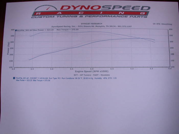

this motor dyno'ed at 323 rwhp & 375 rwtq
Question: why the big different is tq & hp? What controls the rpm range of hp & tq? What would it take to get 375 HP & Tq? I know that several components have an influence on tq & hp but I would like to better understand it.

One point on the print out, did they give you a reason for the 'ripple' in both the tq/hp lines in the 5250rpm region , ignition- fuel supply-revlimiter-valve springs-wheelspin ?

They did not explain the chart. Because the car would not crank with the Jacobs ignition box, I dyno'ed it with out one, stock distributor and high output coil. Later I bought a Mallory box and installed it. Would not crank. I called Mallory and they said that the chip (SCT) was not compatible with the box but a 6855M was. I ordered the new box, but have not received it. So maybe the ripple is ingition? I hope so. Fuel supply is good, rev set at 6500, value springs are good to 6800, I don't think we had wheel spin, but who knows. If they have a dyno at the LCS I may get it dyno'ed again. I have driven the car about a 100 miles, pulls like a freight train. I'm working 7 days a week and 10 plus hour shifts. Very little time to play with my Cobra.

What I would tell you is that the hp peaks when the torque starts to drop off faster than the rpm is going up. Your torque starts dropping off around 4500 rpm. The torque is dropping off because the air flow through the engine is not able to increase at a 1:1 ratio with the rpms. In other words, the engine is not able to breath as well above 4500. If your torque would stay flat to 5252 rpm then the tq = hp.
Generally if you open the ports, or increase the durration on the cam, you will get better torque at higher rpm, but you will most likely loose tq at lower to mid rpms.
My guess is the intake, mass air, or throttle body is limiting your engine. If not on the intake side, I would look at the exhaust side next.

Like other people have said before, your combination ( intake, heads, cam, exhaust) does not appear to make alot of torque at higher rpm, and the torque drops off faster than the rpm increases causing an overall decrease in hp as rpm increases at higher rpms where you need to make good torque to have impressive hp numbers.

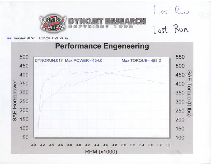

Here is a chassis dyno of my engine, 427 SO, high-riser heads which have much bigger ports than yours, single four dual plane intake, 2" headers. I'm also running a bigger cam, duration 240, 245 or something like that, .670 lift. You see my torque begins to fall off as well, although not at the same rate as yours, with HP still creeping up at 5900 rpms.
