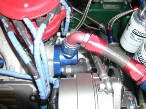

Old 06-08-2007, 06:37 AM
Roscoe's Avatar
Join Date: Mar 2000
Posts: 5,900
Roscoe

Roscoe,
My water pump on the Shell Valley 302 Cobra I just bought looks similar to your picture. When examining my water pump I discovered another inlet just below the top bypass. It had a hose clamp and a broken piece of hose on it. Was this capped somehow and broke off? I have no car heater.

Bill that is the one that would be attached from a heater core with another hose taking presurized coolant from the top of the intake manifold to the heater core too. Napa & Ford sell a small rubber cap or it can be internally threaded for 1/4" pipe and a tapered pipe plug used for a more secure fix.

Old 08-28-2007, 06:49 AM
Roscoe's Avatar
Join Date: Mar 2000
Posts: 5,900
My Edelbrock pump has threaded ports. I blocked the lower one. As said, you can purchase rubber caps locally if yours are not threaded.

JAC...Run the bypass hose as is shown in ROSCOE'S picture. It is available at NAPA.
My Cobra did not have it on the 351W engine when I got it. It had rubber block off caps installed. One day I was showing my car to a friend and as I brought up the RPM to about 4,000 we got a big suprise.
The cap blew it's end clean off and I had a huge anti-freeze mess all over the motor and engine compartment to clean up.
Believe me, run the bypass hose. Save yourself alot of grief. The engine is designed to have it and needs it....Gordon
