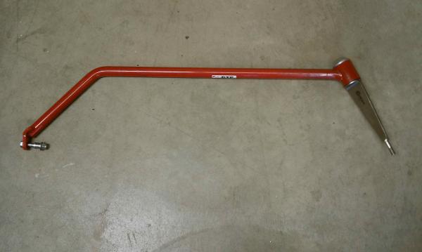

It depends on how far you want to go. I have mine setup for Autocross. Very rough on the street but handles great on the course. 850 LB springs, Penske 3-way adjustable shocks, Modified GTP front swaybar, this was to make it adjustable (see pic). No rear bar. 285/30/18 front and 335/30/18 rear (Hoosier A6's). If you are doing track days it would be different.
