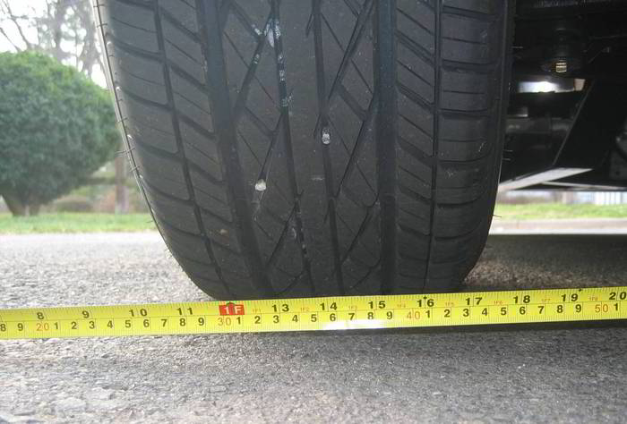

Originally Posted by ztarum View Post
Are you sure? It looks like the tread width is the same or slightly wider for the 245's.
Interesting ........... Are you saying that whilst the Avid S/T's may have a larger "Section Width" (cross section) they actually have a smaller contact patch? I assumed that if a tire has a larger section width then it would follow that it also has a larger contact patch (tread width).
I see on the Cobra Tire Page that the Avon CR6ZZ 245/60x15 has a tread width of 8.7" ....... now I just have to get my friends car back to measure his 255/60x15 Avid S/T's. This may take some time ............ anyone with the Avid S/T's and a tape measure?

Remember, Inflated dimension will measure differently than loaded dimensions. I would want to compare both tires on wheels, inflated, on a rim, OFF the car and see too...
The Yokohama site shows Overall width for the Avid S/T 245-60-15 as being 9.9 inches and the Tread width itself as 7.9 inches. Here is the link if you want to check it out.
Regards
Funny you should ask.... These are 235/60's on the front.
Old 01-27-2008, 10:55 AM
Posts: 22,025
... and the rear 295/50's.

the Avon's have a more square shoulder to the tire. the Avid's have a rounder shoulder profile.
