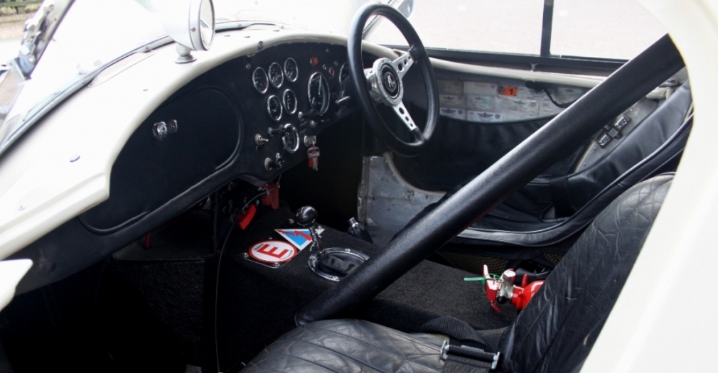

The lever has the correct working 'T' mechanism but as you can see, my shifter is a Hurst Comp Plus and the reverse lockout isn't a feature of this shifter.
Glen

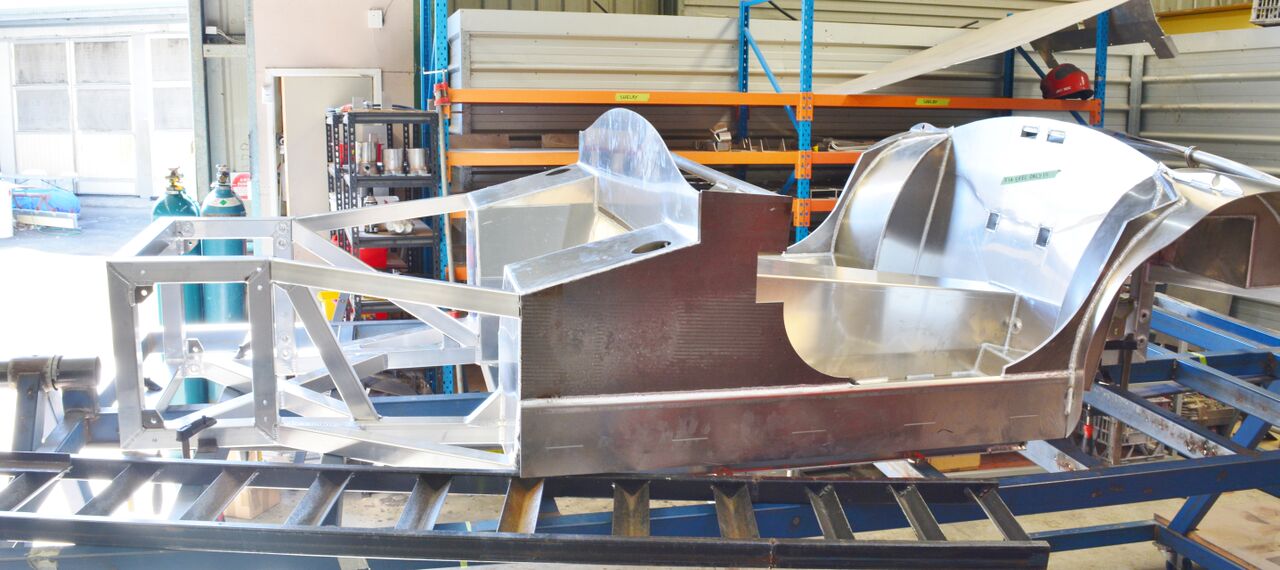

Another milestone....chassis construction is completed.
Glen

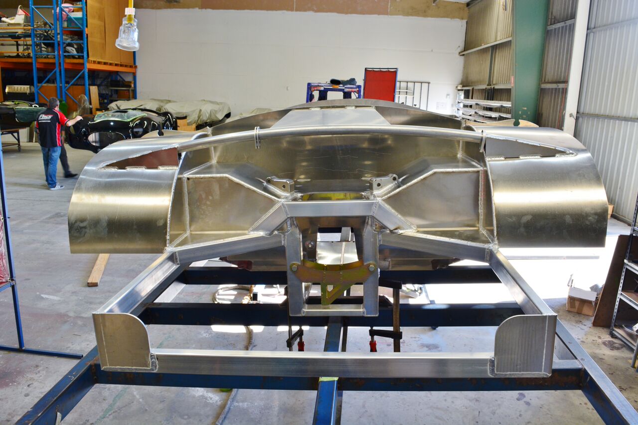

Tim,
The fuel tank is custom and mounts below that "outrig" at the rear.
The roll bar attaches on that ledge behind the driver and into the boot as usual. There are steel shear plates you attach behind each point, and you drill the holes once everything is lined up. The mount points and rollbar are separate, so can be dismantle if required.
They do it this way now I think mainly because you can also get the optional passengers side roll bars, and it will make a LHD chassis simpler too. And it is easier to line everything up this way.
Cheers!

Here is a shot of the fuel tank installed in a 427...
....so in my car, being an FIA replica, not a 427 - the fuel filler will be located behind the driver. FIA-bodied cars, LHD or RHD, all have the fuel filler located on the RHS.
Here's COB6008 for a graphic of the filler location:
And yes, AP2289 will have the 289FIA-correct forward braced roll bar. The mount for the forward brace is on the left side of the transmission tunnel, a little forward of the gear shifter location.
Here's a shot of the roll bar bracing in....COB6008:

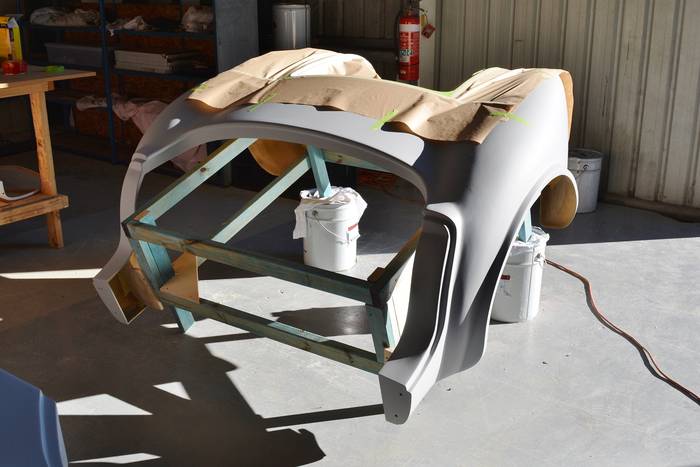

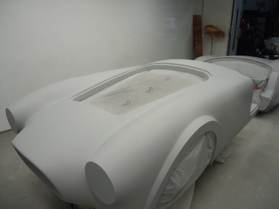

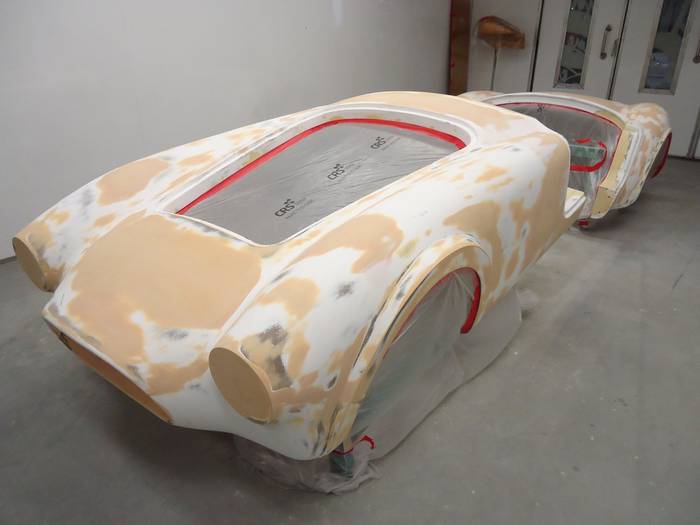

It's been several weeks since an update, so here's the latest....
Chassis fabrication was complete at last update, so now attention turns to the body prep and mods.
There are a number of steps that the body will go through before it is married up with the chassis. At the moment it's in two halves, front and back, and it has been prepared for painting.
Here it is at the painter's after filling and sanding by AP to achieve their required quality standard....
Here it is post-painting....
Those with sharp eyes will notice that it still has the standard roadster guards / fenders, and also there is no FIA oil scoop under the nose opening. Yes, OK, can't quite see the no-scoop in this picture.
What happens now is while still in its current "roadster" (front section) configuration, AP will take a splash of the current shape to create a mould before they change the roadster front section to suit my FIA requirements,
and that way they will have options available for future clients who want a 289 roadster.
After the splash, AP will modify this front section to the 289FIA configuration (FIA-typical front flares and oil cooler scoop, similar to what you can see here on CSX2323....
(One of your's Tim. Thanks, nice shot)
More soon.
Glen
mate, LoBelly, Dimis and 1 others like this.

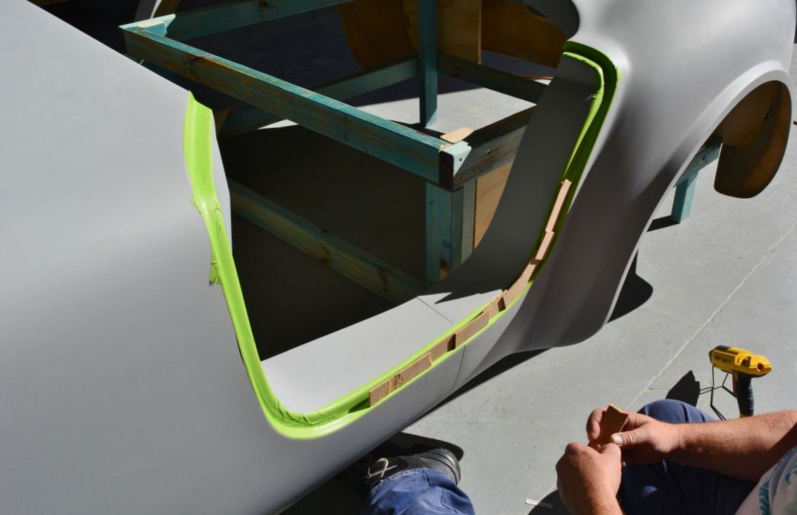

A couple more update pictures from AP....
The body halves are temporarily mated to check door fit. Bonnet (hood) fit is being checked as well. A splash of both halves is soon to be done in the body's current config., hence the smooth bonnet.
Checking door fit:
