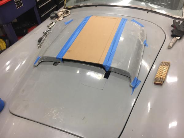

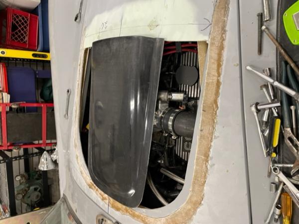

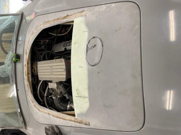

Mr Bruce was kind enough to make a repair plug for the hood to restore it to start fresh.
I went from this scoop
To this opening
To this patch I will need to fiberglass in
This scoop is off of ebay-
I will glass in the patch, then locate the scoop and cut a new hole, and rivet the new scoop onto the hood.
