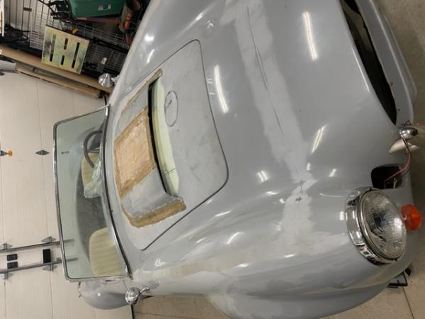

Well, a slight mishap during the reassembly. I had installed the windshield. It was a bit tight in the center of the cowl, gap on the sides. I am sure the mold just varied and the curve a bit too much. As I started to attache the side wings, I made sure the screws were not too long. Started on the visors, checked again the the 1st 2 holes are clear. Did not check the 3rd hole, "CRACK". It appeared the glass had been forced to the top of the frame on the passenger's side and the screw just nicked it.

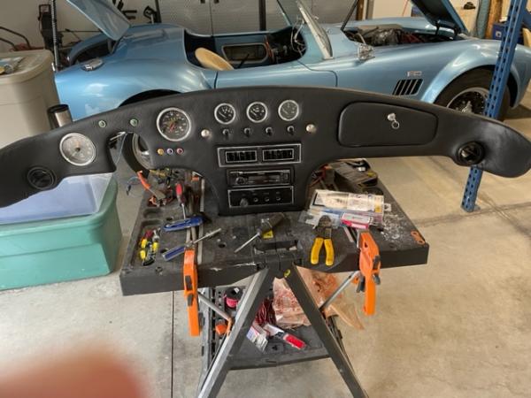

I had the dash recovered in a nice black vinyl. The original beige cover had been pretty beat up over a period of time.

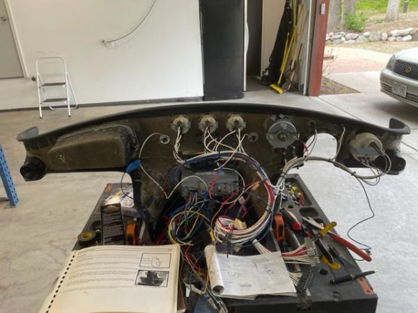

Now I have been working thru the wiring.
As I tried to figure out the wire runs, I realized the fuse block had no labels for which fuse protected which circuit.
I suspected it was a custom aftermarket harness, but nothing had a name on it. I guessed the fuse block was possibly a Painless Wiring unit. It turns out it is the same block as used on the Chevy C10. It makes sense since the steering column is a Chevy Chevette, the connectors needed are the same on the column. The wiring numbers are different from the C10. But the fuse layout seems to be the same. I can only guess Painless made it custom for CR or CR made the loom using the Painless fuse block. I suspect the former.

There is a picture of the fuse block with fuses labeled in dscott’s gallery.
Could be the one you have maybe, it matches mine.

That is the one. Thanks Sunman.
