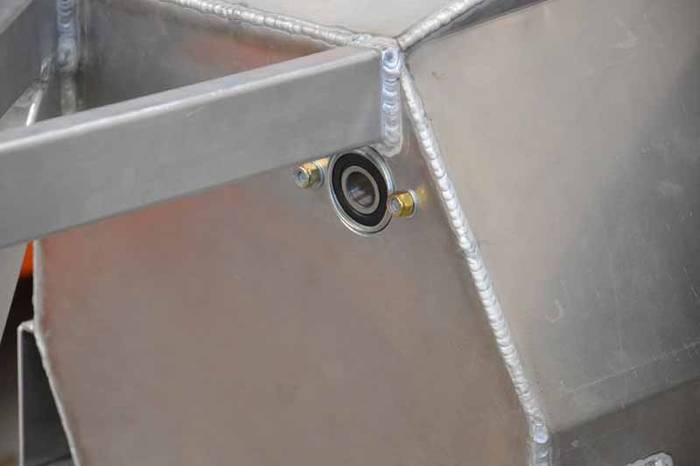

What do the suspension brackets bolt into? Do they have nuts on the back or a threaded crush tube?
Any concerns about dissimilar metals? I always wonder about that with using high tensile bolts in an alloy motor. I use stainless if not structural, but obviously not an option in suspension.
Old 06-01-2013, 05:00 AM
400TT's Avatar
Join Date: Jan 2004
Location: Gold Coast, AUS
Posts: 2,145
Zedn, crush tubes and the bolts that mount the suspension brackets bolt right through the crush tubes with hardened washers & nylocks.
To solve the problem of dissimilar metals we use and recommend anti-seize for threading rod ends etc into aluminium suspension arms. And loctite on everything else that does not have jam/lock nuts.
This is ample from our experience.
There are other products that are suitable, these are just the ones we use.

Steering Shaft Bearing

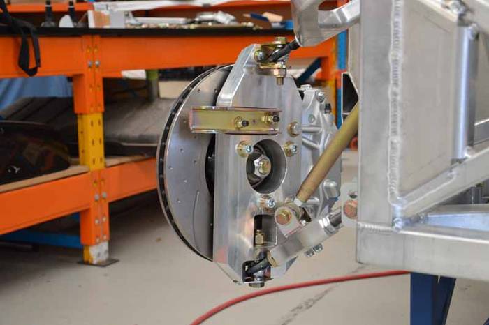

Rear Upper Wishbone waiting for its Mate
Front of the Chassis

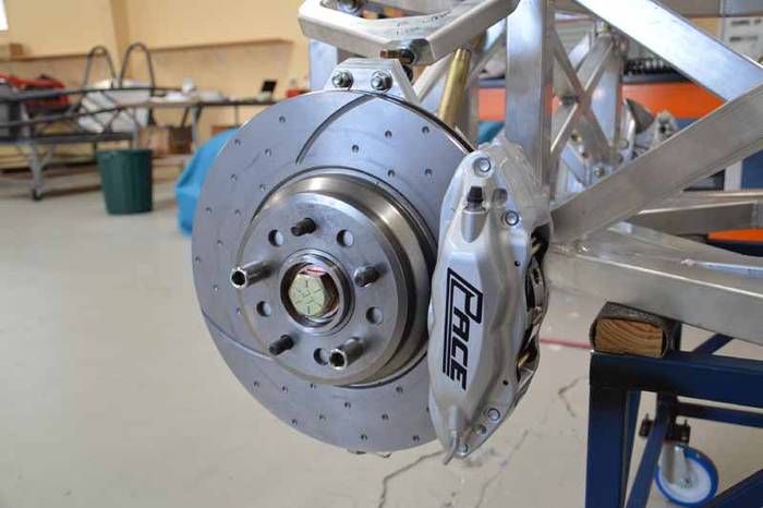

Close Up Of the Brake Rotor
Brake Rotor and Pushrod for the Bell Cranks
Brake Rotor and 4 Pot Brembo Brake Calipers
