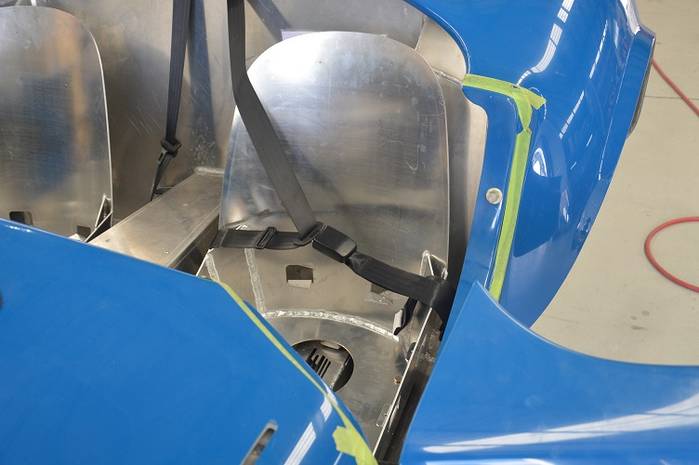

I have just finished sticking Resomat to every conceivable surface in the cockpit. Are you going to do the same with yours?

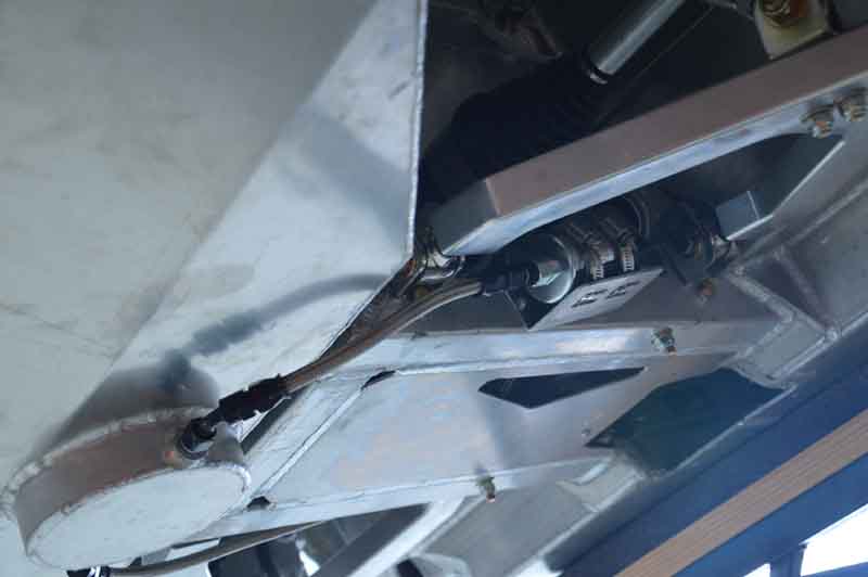

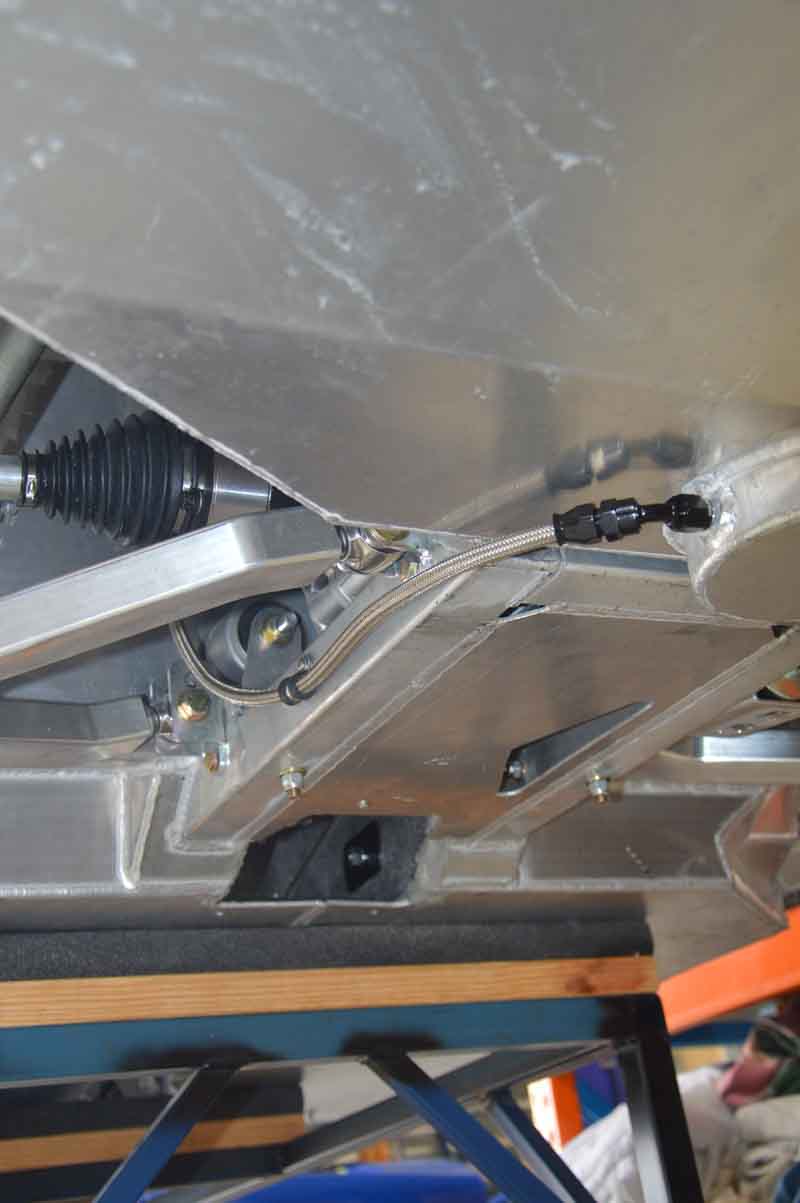

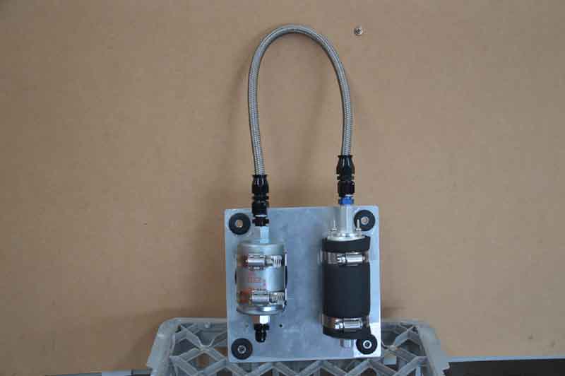

Hi Richard here are some Radiator Pictures
Radiator Passenger Side
Radiator View of the Top
Radiator Hoses View from under the Car
Fuel Lines Finished
Master Cylinders Heat Shield
Exhaust Headers Started
Charcoal Canister Lines through the rear floor
Engine Water Hoses
Things are progressing very nicely.
Craig has a heap of new parts on the shelf for me to fit and I am falling behind because supply is really ramping up.
Brad

Thanks for the photos - all of them are a great help for me to be able to visualise how things go together. Can you also tell me how the radiator is fixed to the chassis along the top? I can see the bracket on to the radiator, but not how it fixes to the chassis.
Your car is progressing really well, and looks great! You must be excited to be nearing completion.
Richard
Old 03-11-2014, 08:58 PM
Join Date: Feb 2013
Location: Ormiston, QLD
Cobra Make, Engine: Absolute Pace 427 SC
Posts: 461
Hi Richard
The radiator piece that seals the top between the radiator and the body is bolted to the raised edge on top of the radiator.
You can see the heads of the screws in the photo.
Brad

Sorry - you are right. I meant where does it attach to the chassis. Do you need to drill holes into the cross member that (in your photos) has "6" on the masking tape, above?
Richard
Old 03-12-2014, 01:03 AM
Join Date: Feb 2013
Posts: 461
Hi Richard
You will owe me a beer for this
On the picture "Passengers side" you will see a piece of bent Aluminium which has 3 button headed bolts that attach the radiator support which has the fresh air intake secured in the piece.
I hope this helps
Brad
