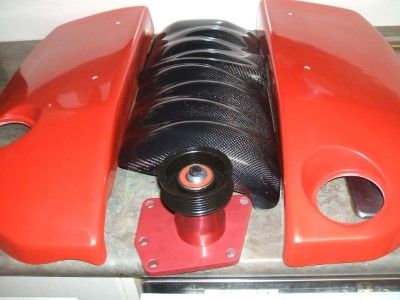

deano59 11-04-2014 06:53 PM
dress up bits
postie rocked up with a few bits and pieces my rocker covers and carbon fibre look a like inlet manifold cover . and also went town to the local chroming place and picked up my power steering replacement pulley in its nice shade of red .
hopefully get the engine down to my mates workshop and swap the sump over and paint the engine ready to drop in for when the chassis arrives .
