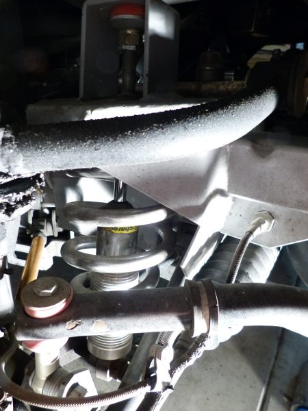

The QA1 GS507 shocks are 2" longer (compressed) than the MS301 shocks on my car - 9.63" vs 7.625". I'm somewhat shocked (excuse the pun) they would be that much longer, especially as we're both running Mustang II front ends. Mine is an original MII front end - is yours, or is it aftermarket?
The GS507 has a tie bar mount on the bottom, whereas mine uses a spherical bearing and 1/2" bolt that passes through holes in the LCA. Maybe that's a clue you're running a different suspension.
Brian

I am pretty sure I have a stock mustang II front end with stock upper and lower control arms. The car came with really old unidentifiable shocks that didn't uses a pressed bearing at the bottom. Where the shock mounts on the lower control arm, it uses a bolt covered by a tubular shim that fits snug in the eyelet hole of the shock. I think the difference between us might be the upper tower on my car, where the shock mounts, is another 4 inches above where the top of the spring is perched out. It looks very similar to what C5GTO has in his pic above. I am not sure if that is a design that was consistent with all of the CR's made. Your setup definitely wouldn't work on my car. With the suspension unloaded My shock length is 14 inches and yours maxes out at 11.
Very different upper mount. Mine looks like this, though it has QA1 coilovers, of course:
Edit: Photo of my car: https://www.amazon.ca/photos/share/I...5x6fU49l7rYwDd
Brian

Way different! QA1 recommending 8 inch 50 pound spring. Does that sound reasonable?
500 lbs/inch is only a bit firmer than mine, which are 465 lbs/inch. I find them firm, but not too stiff. The difference is your car will 'settle' a bit less when weight is on the springs. Regardless, the 18 step adjustment of the QA1 shocks should allow you to dial in how firm you want the ride to be. Mine are normally 4 clicks from softest, but they're installed so I can easily firm them up.
My car had Monroe Sensa-Trac shocks on the rear when I got it. Not only were they too soft, they weren't adjustable. I took advice of QA1 tech support and put adjustable shocks (not coilovers) on there. Big improvement.
Edit: I believe mine are the 8" springs - they just ride lower on the shock body than yours will.
