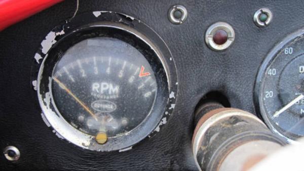

Well, as much as you tried, I don't think you captured the art of the original Shelby installation! Amazing how down and dirty it all was back then, even taking into consideration, the aging proses! Cheers, Dennis http://www.clubcobra.com/forums/pict...ictureid=20179

Dennis - very funny.... LMAO :3DSMILE:
Related to Dirtbag, maybe??
