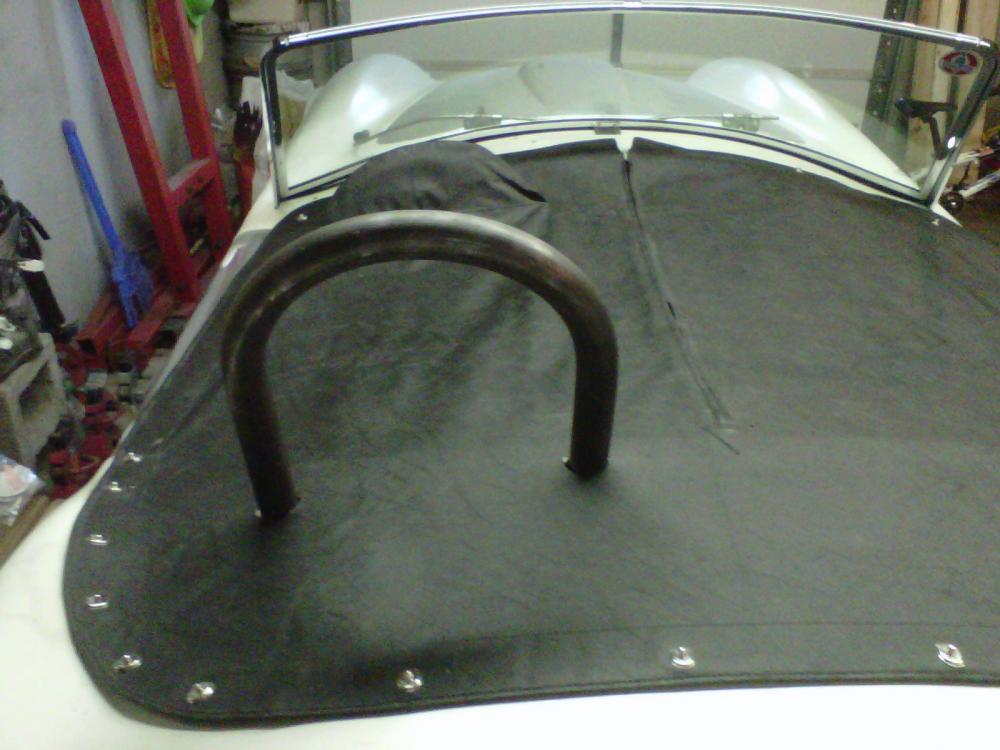

1985 CCX 05-05-2012 03:43 PM
Started roll bar install. Hope the holes are in the right place.....:LOL:\http://www.clubcobra.com/forums/pict...pictureid=7797
mickmate 05-05-2012 04:47 PM
You gonna take the rollbar out to put the tonneau on ? :-)
*13* 05-05-2012 06:01 PM
I was thinking the same... Sewn in roll bar cover?
1985 CCX 05-05-2012 07:38 PM
Course not guys, will add zippers for removal..... Really, I am better than that....:LOL:
*13* 05-06-2012 08:36 AM
We hope so, but you never know...:D

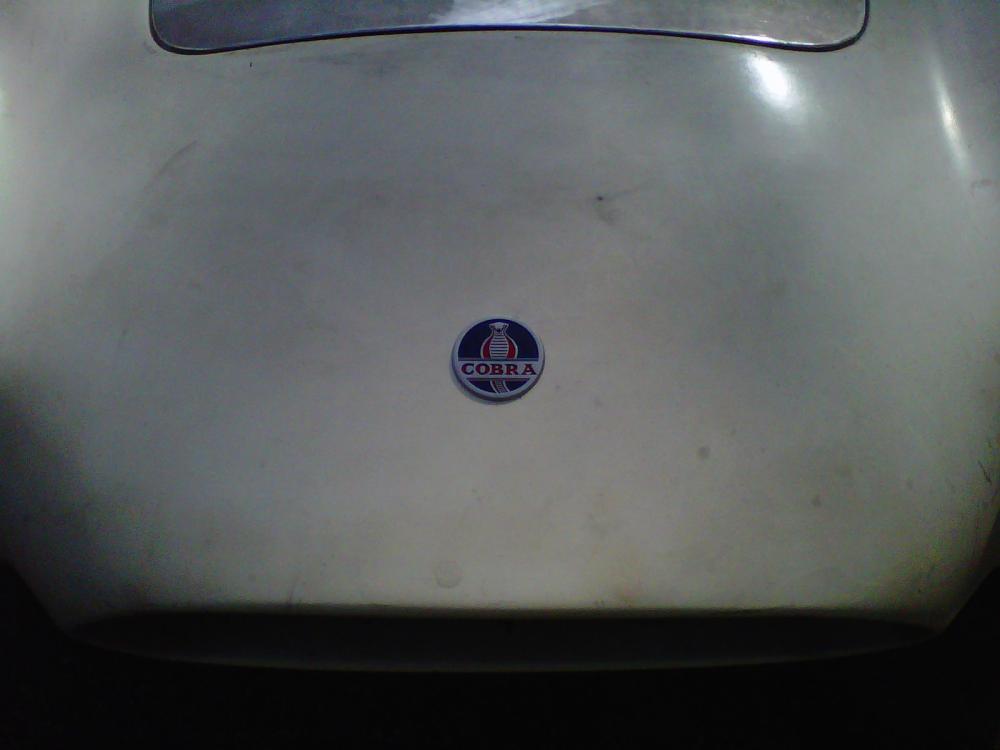

More holes in body..........Getting closer to final block and fill..
Front Deck
http://www.clubcobra.com/forums/pict...pictureid=7804
Rear deck ( I know it does not match the front, if I find one they will match )
http://www.clubcobra.com/forums/pict...pictureid=7807
http://www.clubcobra.com/forums/pict...pictureid=7806
Side Markers
http://www.clubcobra.com/forums/pict...pictureid=7808
