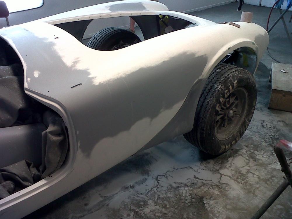

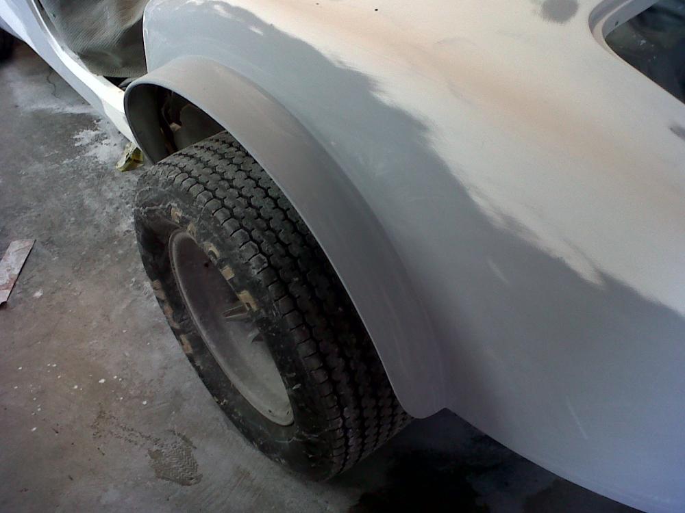

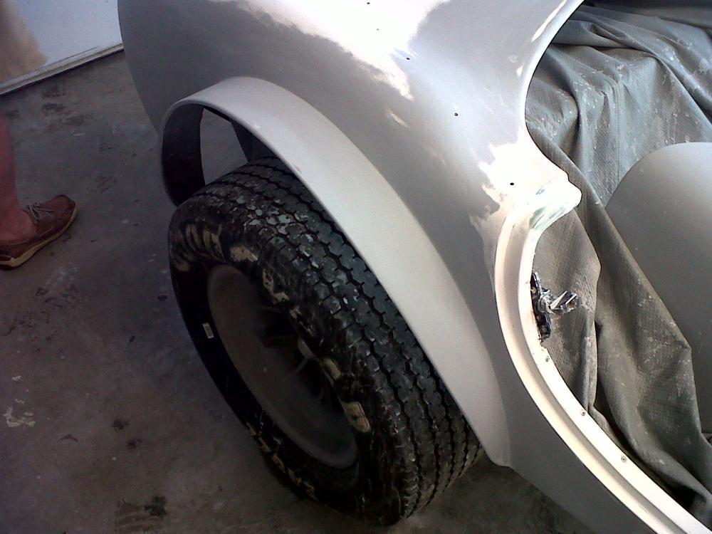

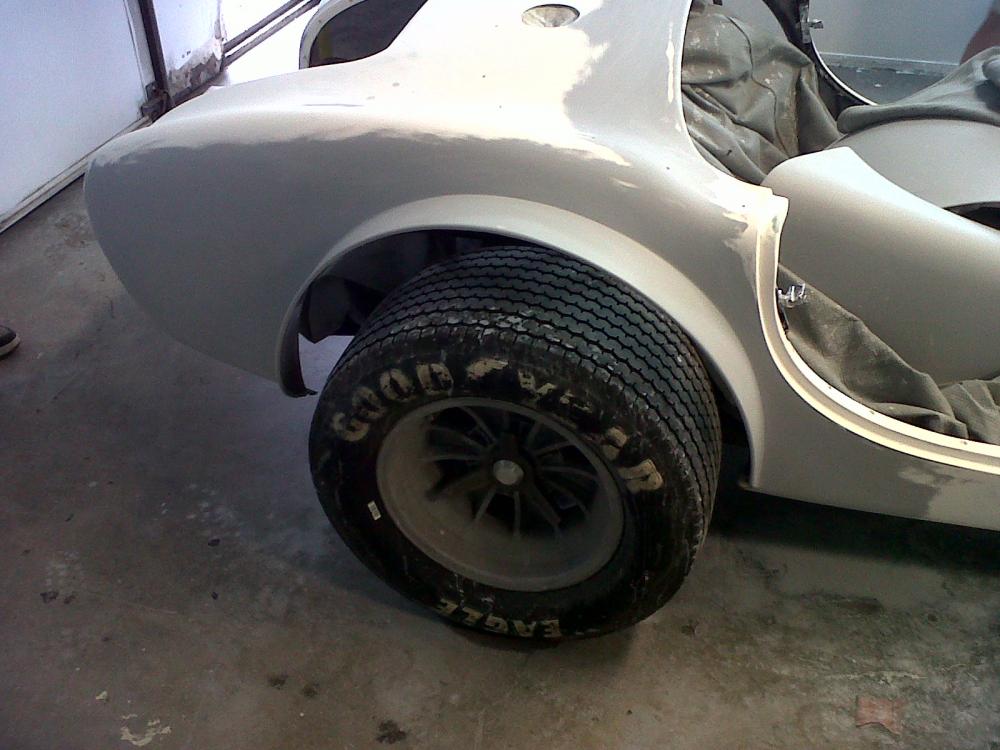

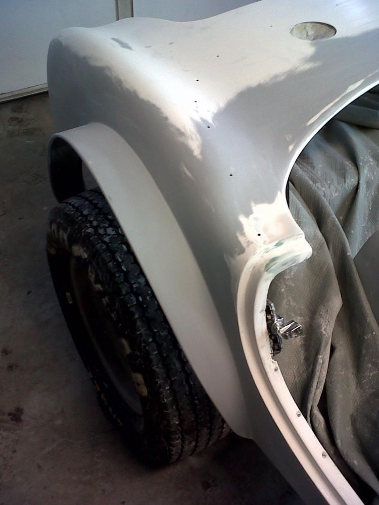

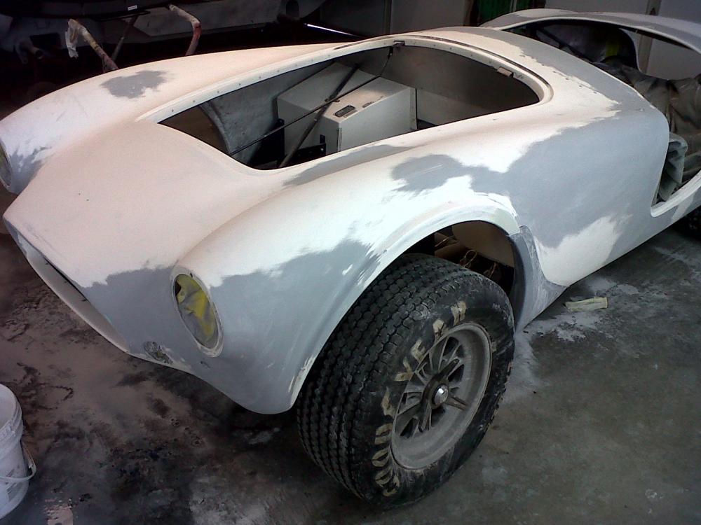

1985 CCX 07-14-2012 07:41 AM
Updates from Restoration Station, New Boston NH
http://www.clubcobra.com/forums/pict...pictureid=8222
http://www.clubcobra.com/forums/pict...pictureid=8221
http://www.clubcobra.com/forums/pict...pictureid=8220
http://www.clubcobra.com/forums/pict...pictureid=8219
http://www.clubcobra.com/forums/pict...pictureid=8218
http://www.clubcobra.com/forums/pict...pictureid=8216
http://www.clubcobra.com/forums/pict...pictureid=8215
http://www.clubcobra.com/forums/pict...pictureid=8214
http://www.clubcobra.com/forums/pict...pictureid=8212
http://www.clubcobra.com/forums/pict...pictureid=8211
http://www.clubcobra.com/forums/pict...pictureid=8209
http://www.clubcobra.com/forums/pict...pictureid=8208

For general knowledge... is it period correct to prep and paint w/ the flair's and
hood scoop in place, vs. finishing them separately and afixing them afterward?
PDUB 07-16-2012 09:29 PM
A wise Shaolin once told me that it is important to paint the parts in the correct orientation, especially with a metal flake, to get the finished product to look correct when putting them side-by-side... so doors, hood, and trunk in place for best results, as well as flares and scoop. Minor overspray is to be tolerated, Grasshopper...
1985 CCX 07-17-2012 09:13 AM
Correct!
All rivots and affixed items were painted.... with car.
If you were to paint scoop separate, especially this color, it would not match.

:CRY: :CRY: Painter went on vacation till mid-next week :CRY: :CRY:
Car is all in primer, couldn't bring myself to picture.... First go around with primer left a couple slight suspect areas which needed a bit more work. Now all on point! At least ready to paint.
