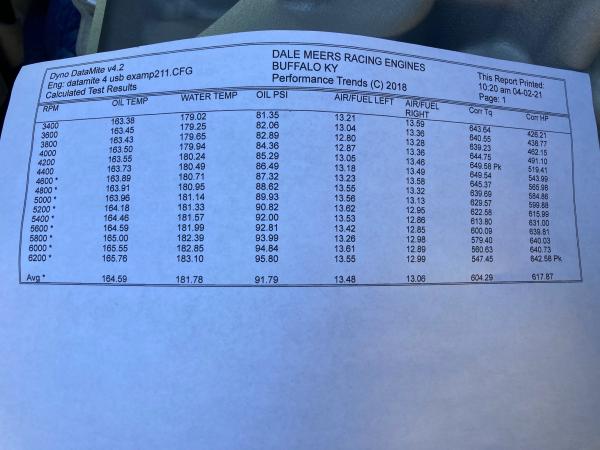

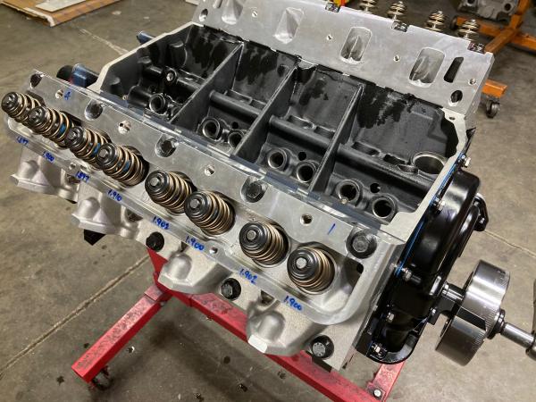

I just had a 496 built that was based on a BBM 427 block. The shape of the combustion chambers looked modern and Lykins used thin rings like a modern engine.
The result is an engine that looks like a 60's side oiler but has the performance of a modern "big block". 640 HP for a mild build with great street manners.
