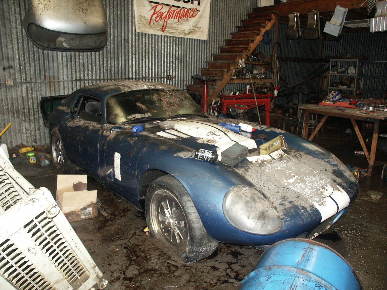

Everyone has been very supportive and the build process is more involved than the Restoration of a 68 KR shelby we did a while ago.
Where we started - When they were let in by the feds ' - this is what they found.
12 Feet of Brackish, sludgery, *****es Brew.
if you look at the Roush sign on the wall you can see the water mark.
The car was cleaned and steam cleaned and re cleaned before we got it. -- it still had to come apart. -
as we received the car, it was cleaned but every time we dug under a panel, moved a wire moved a line light grey ash like silt came from everywhere.
who knew what lurked in the construction of its core, what was trapped inside ready to fill the cabin AC, or engine, or -- --- or---- there was only once answer, it all had to come apart. - But one problem Peter Brock was arriving in less than 1 week to our shop!
so we pitched in and took everything we could out of the car, and boxed it up with masking tape tags, no massive tear down, just the items piled in for transport.
we then immediately washed and washed again. -- simple green was the cleaning agent of choice for the chassis.
We were also cleaning the shop like mad, expecting the event to have many many people. , -- as we got ready , we pushed her into place.
We polished up and had a great event, - then the work began.

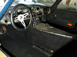

First Steps ;

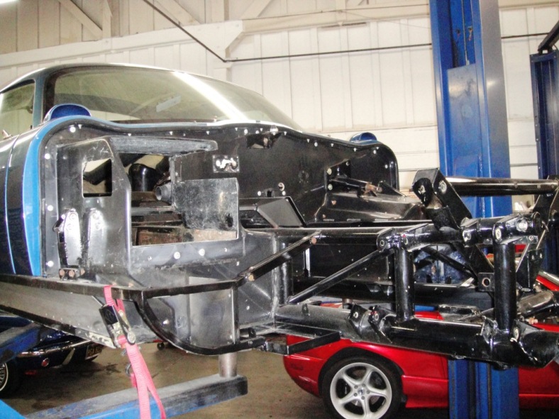

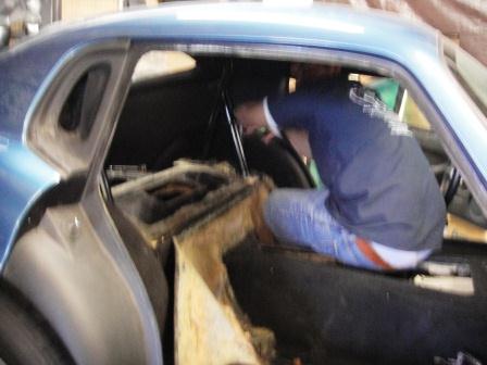

when we examined the car after everyone went home, we found that the "brew" had gotten into everything and had coated things from the inside and out with the aforementioned grey silt. -
We removed all the carpet, all the interior coverings and most everything else.
We went through a few gallons of solvent to remove the carpet glue , and a few more gallons of "simple green" cleaner going after everything.
The brackish water and the co-content of evil brew had sucked the moisture out of anything rubber, it also flash rusted any thinner metals, and really did a number on any zinc coated bolts.
we gutted the interior, pulled the dash, steering and suspension , when we were done the car was a shell, sitting on a frame.
and then -- we cleaned again. simple green - lather ,rinse, repeat.

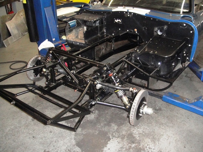

The suspension pieces were cleaned and painted, and the rivets drilled out of body panels. insulation removed and urethane sliced, chewed and tugged.
We learned several things about the car in the process, empty fuel tanks are in fact flotation devices, and fiberglass is great for boats , or in my case , a submarine.

Once we had the complete frame and chassis cleaned and we began work on core suspension reassembly, it started to look like a car again, and that it s key point in any project like this, you keep going down , down , the depths of deconstruction , - can we make it back from here, can we make this better, -- where the H@*# did this come from>?
Luckily, we had access to Friends and a digital camera , the second is immeasurably helpful in reconstruction of this type, - the first is "Double-That".
Since we had taken all the insulation out of the car, and it was a bare internal shell for a Cabin, - we had a clean slate to work with.

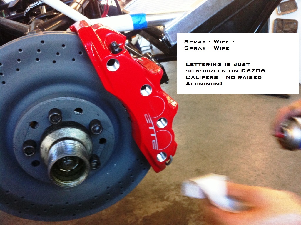

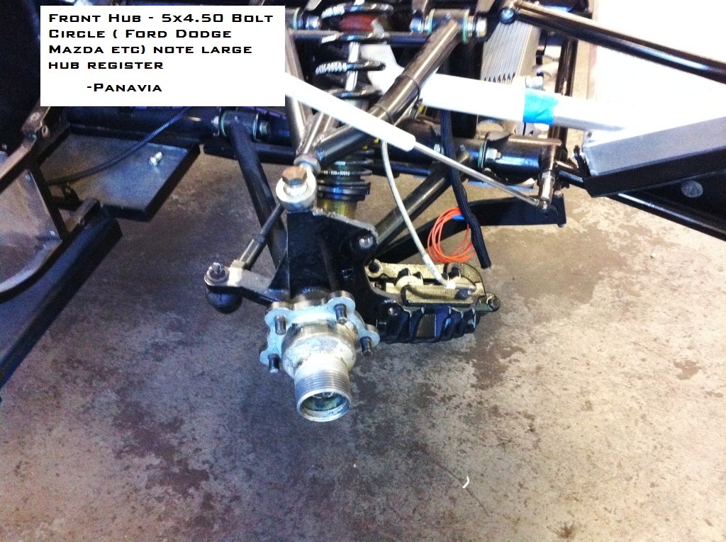

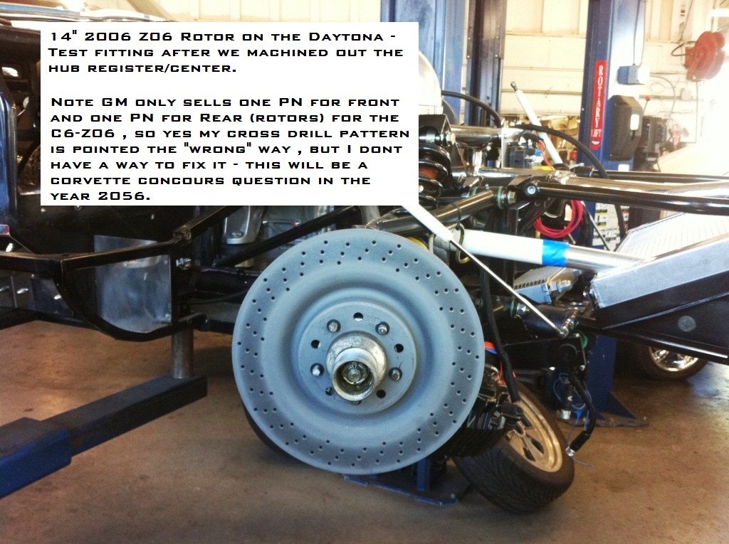

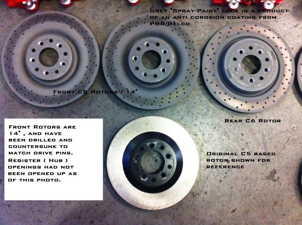

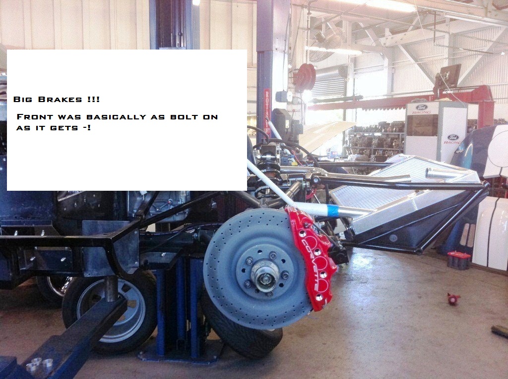

So back to my coupe, - The Rear Diff is new enough where parts have not filtered out to the secondary market yet, so I had to go new. - once we figured out where things came from, a quick call to FH Dailey and we were in business.
In fact, I have visited them several times during my build and they have always let me dip into the Parts Drawings and find what I need.

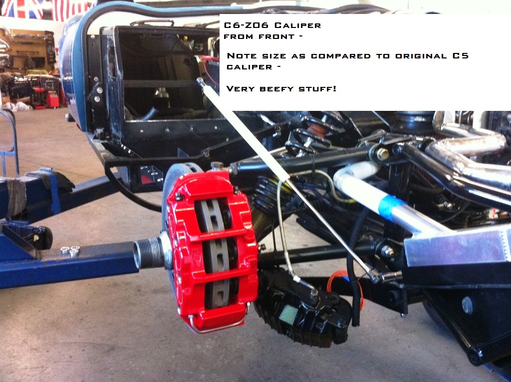

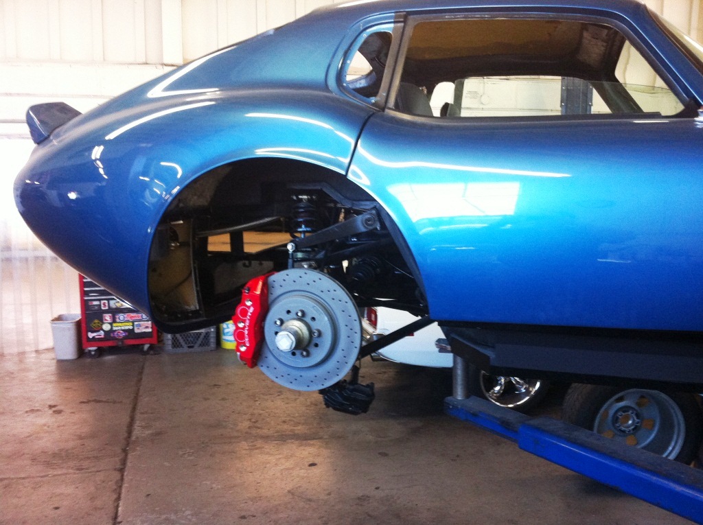

After many a long hour of cleaning and painting components we were satisfied with the suspension and chassis to a point where we could work on the rest of the car. - At the time of her original damage, she was hit with the "brew" and in the weeks and months following that disaster, an important support mechanism fired up and began to work. they flushed the chassis tubes with fresh water and desalinated everything they could. - the salt in the water wasnt particularly high , afterall they were fresh water levees.
however the silt and goop was interesting to say the least. --
When we took the car down to a shell , one thing that had to come out-apart is all the electrics. -- The copper wire inside the lines was black and just nasty, everything from Fans to AC switches was bad, so in this case we are starting from scratch.

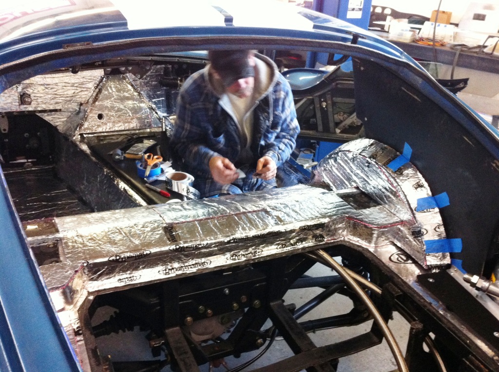

INSULATION INSULATION INSULATION --- so one thing many people have told me over the years in cobra land is Insulate. --! so we did.
I went with a full install of Dynamat sound isolator in the cabin , 360 degrees around the insides of the foot boxes, then a layer of Mylar backed jute padding for underneath the carpet - we then dynamat tapped the seams of that together to allow for a better carpet installation task -- as of right now, 9-9-11 we have not put in carpet, there is a bunch left to do.
Here is bob insulating ! ;

Since the dash was full of silt - it came apart in the mass excavation that was the interior.

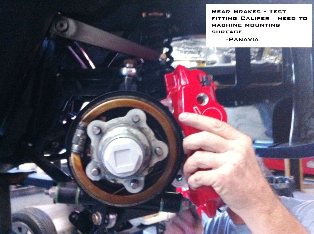

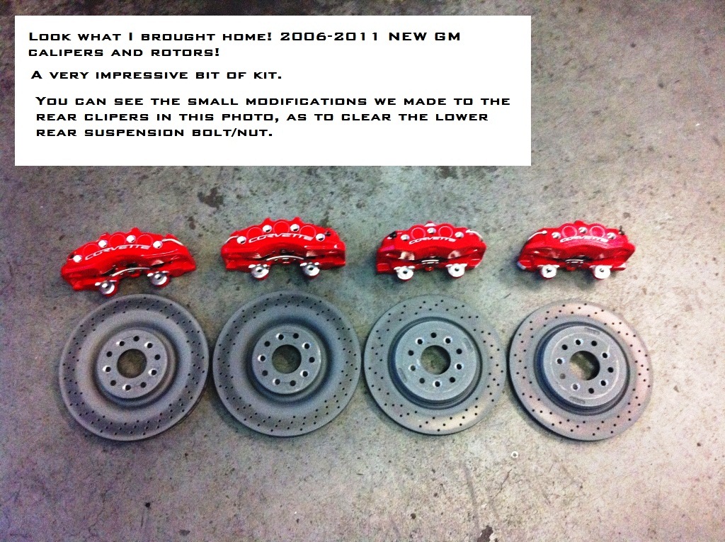

In the meantime we decided to look at a Brake upgrade since we had things apart - I went with a significant upgrade to match the power of the coupe, especially this coupe. - The SPF coupes braking system is a combination of C5 corvette and german based hydraulics.

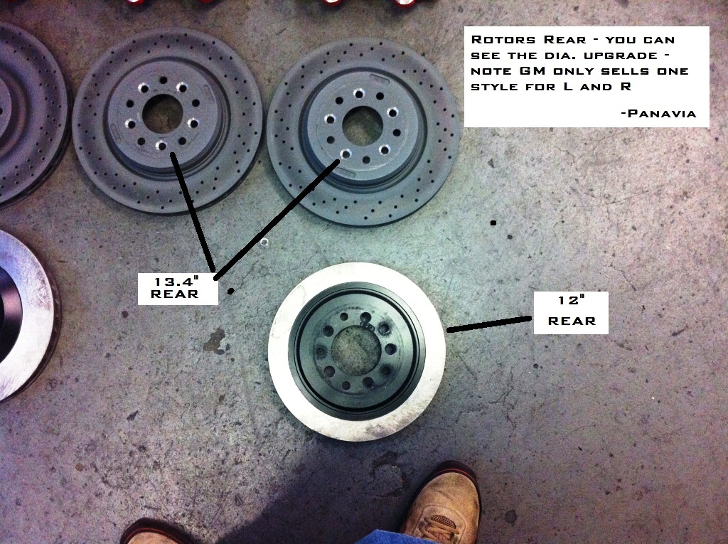

So in looking for the C5 systems in regards to possible upgrades I spent many an hour engineering and reading and drawing up solutions.
I reviewed Many manufacturers offerings ranging from 400$ to 8K. -- lets just say i kept to the lower part of the scale. -

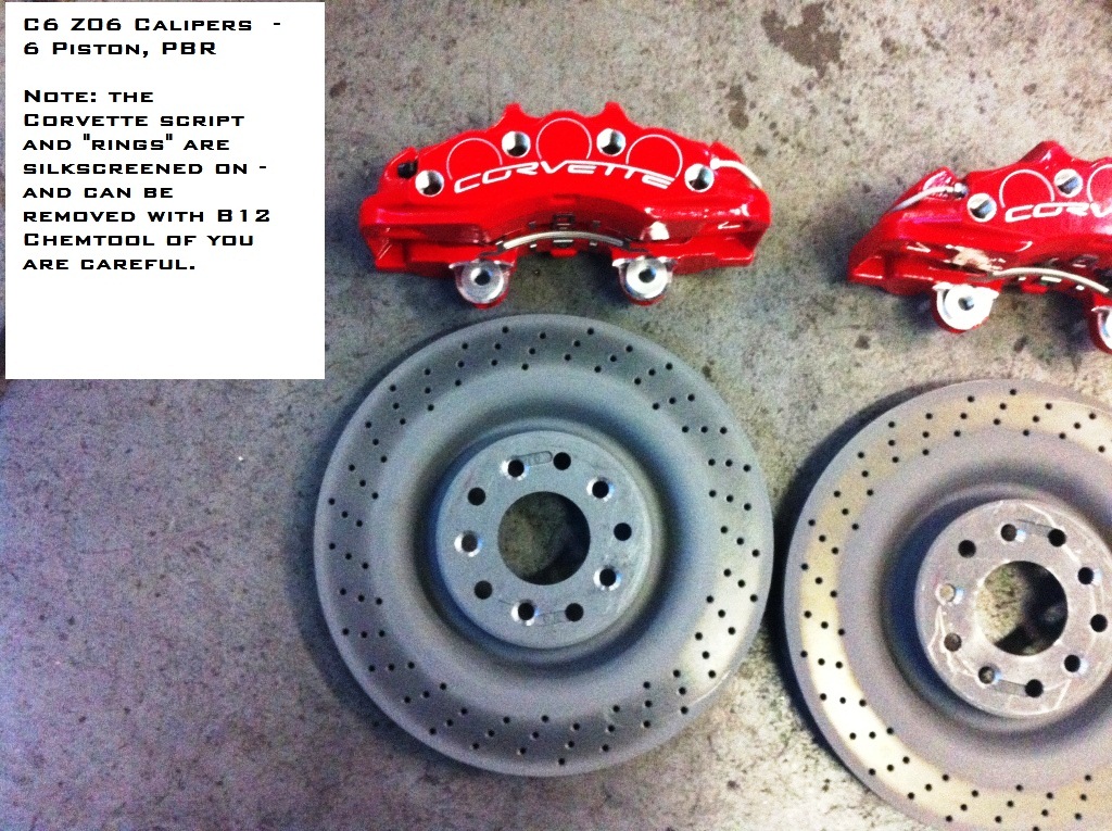

In reviewing what our C5 friends were ( are doing ) i discovered a true find. - the 2006 Z06 Brake system as it sits on a 2006-2011 Z06 - I also looked at the ZR1 system, but that would have broke the bank and then some.
The PBR produced Z06 brakes can be had at your local Dealer and are of reasonable price and value when you look at the competitiveness in this market.
However, a word of warning, -Just because they Bolt-On to a C5 corvette , they dont just "bolt on to your coupe" - some machining and adult supervision is required, -kids dont try this at home.

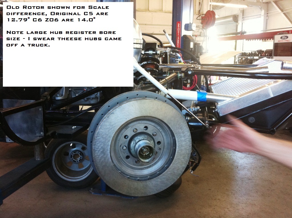

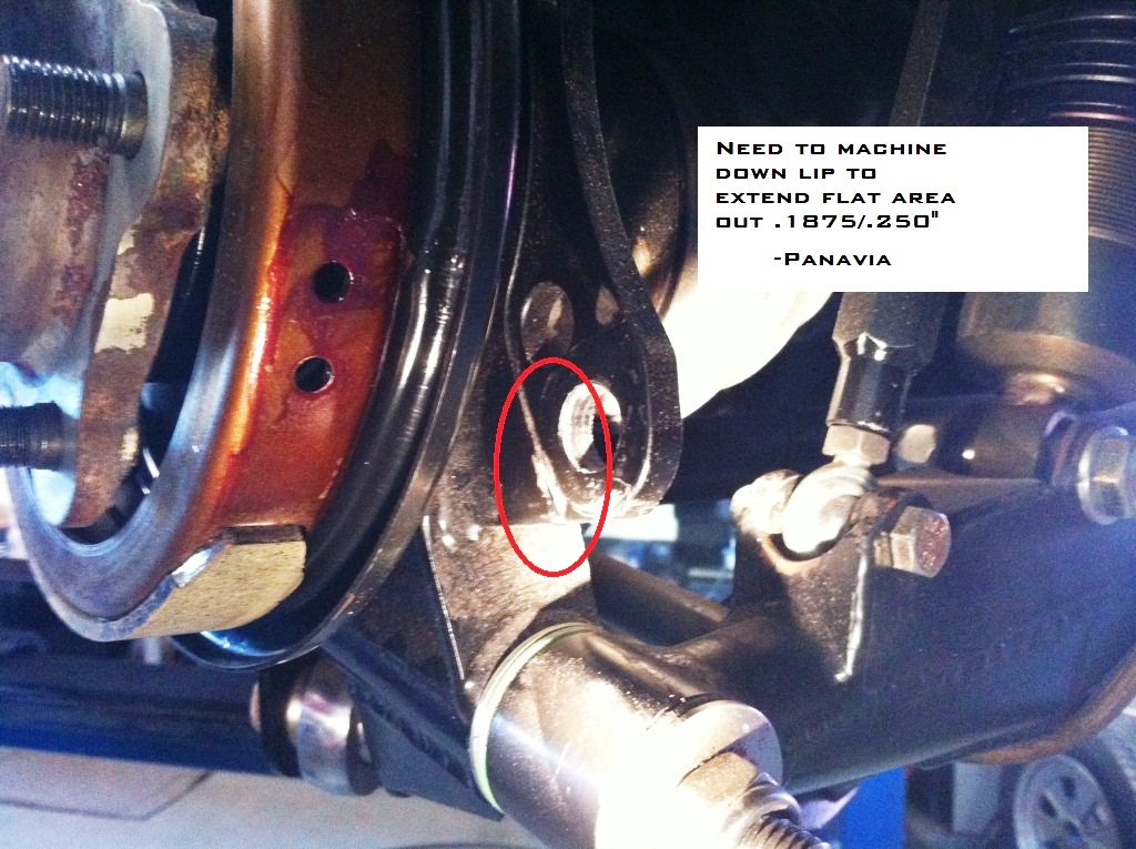

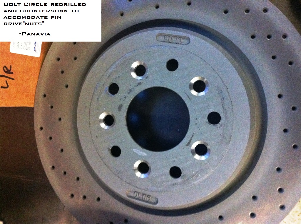

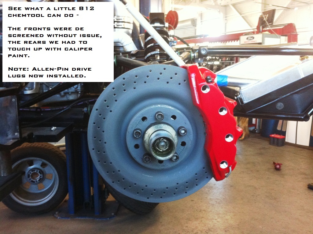

The Rotors as obtained from SPFs supplier originally are modified to fit the coupe -
here is a list of mods that they do ;
1. Drill them out a Ford / Dodge / Mitsu /Mazda bolt pattern of 5 x 4.5" for the lug/pins to go through, these new holes are also countersunk a bit for the base of the Pin Drive lugs to screw down on top of them.
2. Bore/Mill out the Hub register (big center hole) to fit the hubs on the coupe, radius the backside cut so it mates to the hub and seats ( sits flush )
This took some time to do and we had to have the centers done at a Larger machine shop with a larger lathe to bore the center out precisely, and have it be a concentric circle with the hub.
We then found that the Calipers originally had a 2 piston single sided front, with a single piston , single sided rear caliper. - in the Z06 (2006) this was upgraded to 6 pistons front, 4 in the rear, - I know Jeremy Clarkson keeps saying more is better, so we went with it.
The SPF calipers on the coupe are basically stock with script engraved in the fronts. since mine were damaged, they function OK, but look like hell even after scrubbing and painting - So we went with the C6 Z06 Calipers.
See the below photos for detail, - questions welcome.
Keep in mind I have not road tested this yet, and chapters are still being written.
More news as it happens !!

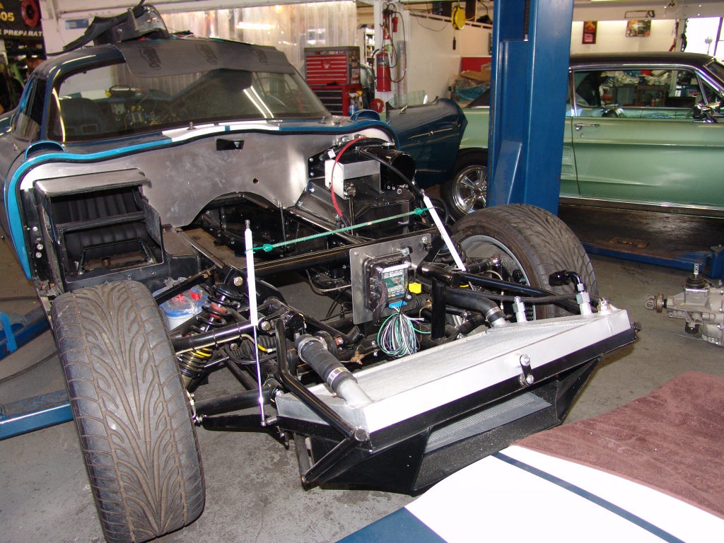

Update 10-11-11 = ! Well we are making good progress and I will be segmenting and uploading more photos and interesting content. --
If you look, I have begun to segment the updates in sections to make relevant materiel available to folks for the part of the car they might be working on - Like - Radiator , Brakes, Steering, AC, Shocks, Fuel tank, etc.

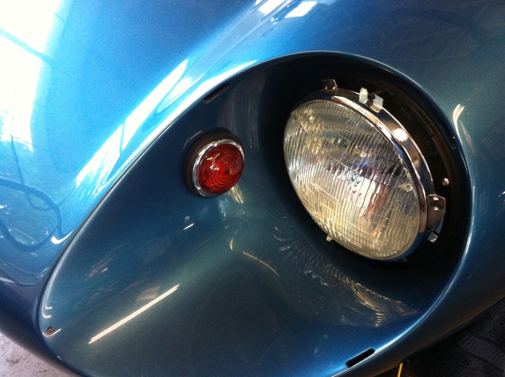

Head Lights; the Front headlights are a Wipac bucket, with a Wipac H4 carrier 7" lamp that contains a small parking lamp bulb as well as an H4 style headlight. They are available via the British Parts connections , however I was able to Obtain a stock set of takeoffs from #139 as he has retrofitted a Lucas tri-bar style lamps and I bought them along with many other take-offs.
The Wipac Plastic Headlamp Buckets and trim rings are no different than the units used on the Cobras-
Front Turn Signal lights - The nose lights for right and left signals came from some sort of motorcycle application and I found and sourced some versions on the internet. The OE SPF units are sourced from a SA lighting supplier , but the form factor is the same as many bike lamps. - they can be replaced easily.
However I personally just did not like them , so I performed a mod that is a degree rotated version of something I had seen on other sports cars with this style of enclosed nose/covered headlamp. We took a Lucas repro L488 light with an orange lens and created a mounting to take up some of the concave cavity and allow the 488 to be displayed in the nose.
