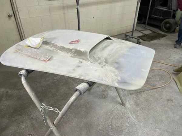

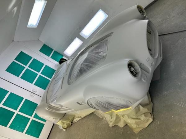

The body shop applied the 1st coat of urethane primer for fiberglass, sanded and preped for 2nd primer coat.
We reworked the original hood scoop buy removing the 8" of added width (modified for previous supercharger now removed) and reinstalled with a 3 " added strip in the middle to clear the EFI system.
James block sanded the entire car, carefully looking for imperfections and pin holes.
He then did another coat of the primer.
I decided on Viking Blue 2 stage paint with no stripes.
The car should see color this coming week!
