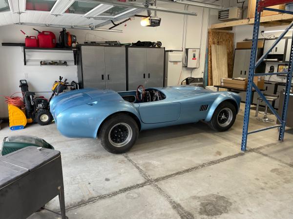

The body shop applied the 1st coat of urethane primer for fiberglass, sanded and preped for 2nd primer coat.
We reworked the original hood scoop buy removing the 8" of added width (modified for previous supercharger now removed) and reinstalled with a 3 " added strip in the middle to clear the EFI system.
James block sanded the entire car, carefully looking for imperfections and pin holes.
He then did another coat of the primer.
I decided on Viking Blue 2 stage paint with no stripes.
The car should see color this coming week!

Color on the car!
Did not get to see the car yet. James sent me this photo last night just to tease me.
Hope to get there this afternoon.
I am happy with my choice of color.
1985 CCX, G_Edmonds, xb-60 and 2 others like this.

He knocked it out of the park! I got to see it today- still in the booth. The color looks even better in person. He has to color sand it & buff it yet. I am very pleased with the paint and really like the scoop.
The scoop is not like an original 427, but the whole car is more of a "tribute", and I always accepted that.
I have always enjoyed the story as to how the riveted scoop came to be. They had tried a new config for the motor intake and the hood would not clear. So, someone went down to the closes speed shop and grabbed a fiberglass scoop, cut a hole and riveted it in place.
Then, it somehow becomes an "engineered add".
The color seems to really enhance the curves, IMHO.

My CR came home today! Very happy with the color.
Have to remount the hood hinge.
Now starts the reassembly. Also, the wheels have to go. I will get tires on my 5 pin knock off Cobra II wheels.
