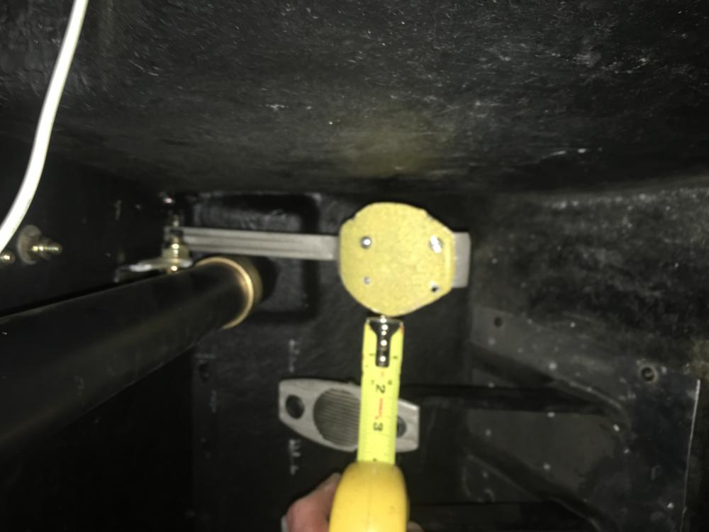

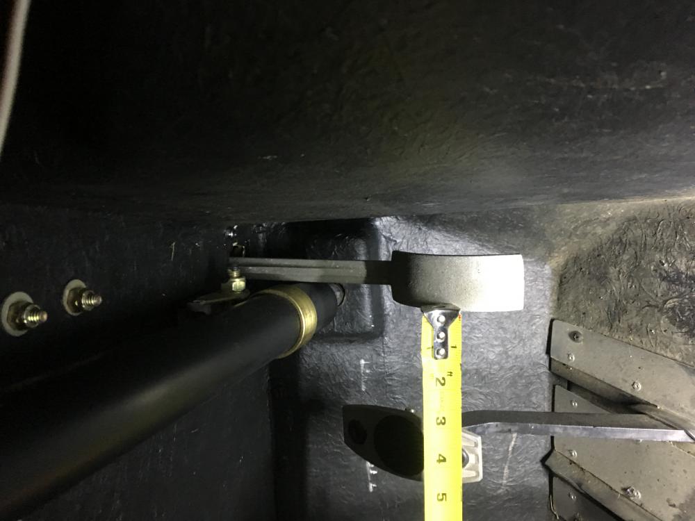

Also worked on the throttle pedal today. Last year was having some difficulty doing heel-to-toe due to the large gap between the throttle pedal and the brake pedal. Pease forgive the orientation, they were upright on my computer but were rotated when placed in my album.
So I found a spare throttle pedal that came with my MGB race car which had a wider plate welded to it. I removed the plate and cleaned it up. Glued some 80 grit sandpaper to it for better grip (old racer's trick). And then attached the plate to my existing throttle. Went from a 3" gap to a 2" gap. Heel-toe works much better now.
More work to come over the next couple of weeks.

Very nice solution to the pedal gap issue. Good luck with the upcoming race. Weather has been beautiful down this way, hope it continues to be nice for you at Summit Point.
