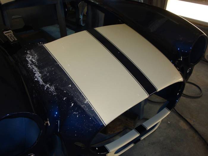

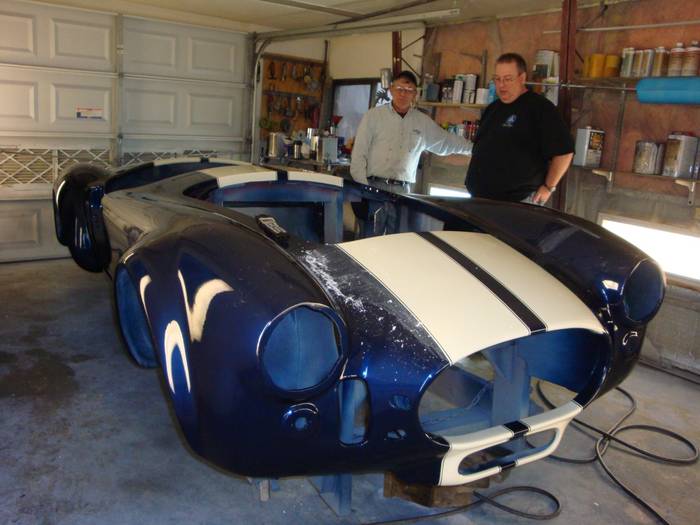

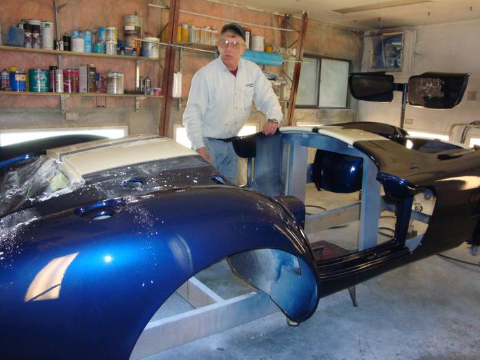

Well. Another Saturday and another visit to DVs shop and the first thing I have to say is.... Boy are we getting close to the finish line! !
The second thing is... Man. When you see a true craftmans work, it is impressive. Got to see first hand DVs razor treatment to perfect the finish before the last final coats of clear. It is something you have to see in person, but I can tell you the quality of the final finish will be spectacular!!!
Here's a few pictures....
#2
#3
And the man himself... DV

For those that have asked, close up / detail pictures of how I do final paint work.....
First one is of the second door final painting. Still has too much orange peel for my tastes- Second picture shows the left of the same door with the left 'shave' to finality.
3rd picture is a small sag I found today on the LR fender-'scraping' started.....
4th picture is final sraping, 600 wet sand then 800 wet-ready to buff.....
Good luck and for the rest of you, you can still call me nuts
