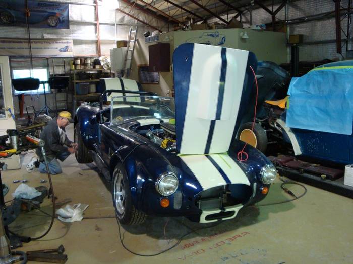

OK... Here's a few pics from yesterday visit to DVs shop. Progress still being made. ( 2 more weeks, right DV )
A shot of the rear end with the body fully down and bolted up
Electrics getting mount in the truck for the last time
Getting the hood fitted
Still working on the hood fit

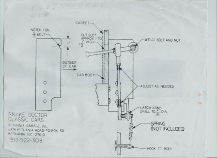

I used a set up somewhat like this (Thanks Art Burtt for the idea and picture).
But I used Watsons B19 neat knob assy and a ball joint from McMaster-Carr on both ends.
http://www.mcmaster.com/#6058k25/=2bfcnv
along with some 1/4-28 threaded rod and locknuts.

Terry I saw that, NICE and I like it, but (isn't there always?), wait til you see what I do with Ed's! Wont have to turn around or try to strteretch your arm to get to them!
