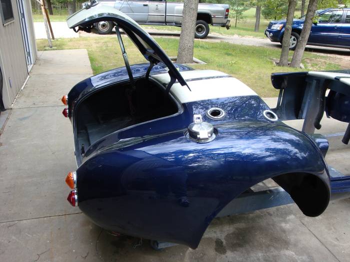

Back from another trip to DVs place. We got the body on for the last time. Many thanks to Robert (aka Huckleberry) for making the drive from Plainfield to help getting the body dropped on.
Here's the body still on the buck out in the fresh air and sunshine
Here's one of her rear end
The body and frame are one (sort of) Robert and DV trying to find out where we're hung up on the firewall

Say, "Thank you Diane!" I was pulling my hair out trying to get that firewall in place without haveing to buy another porta power to replace mine, she said 'can't you use the holding rod we used to hold the cargo in place in the trailer!' It ratchets, has plenty of lenght and is half as wide as a porta power! PRESTO-five minutes wth this thing and the body dopped with a THUD! Not a crack! .
Ed it fit so well all the bolts I drilled and tapped to mount the body six months ago (?) all lined up perfectly! Even the back deck after I moved the rear wall back.
I'll post more pictures later, but even the header cut outs line up!!
The real boss, she should have been an engineer!
DV

This is how we put Diane's solution to work-what is shown is the rear or the
'pole' against the rear inner firewall-the front is up against the top of the firewall,
Firewall pushed forward so body dropped down-rear firewall now fitting exactly where it is supposed to be!
Rear of the body in place,
Front of the body in place,
How about that....after the long freeze the body is totally down and bolted in place!
Lot of 'stuff' to go but it is all down hill from here!
