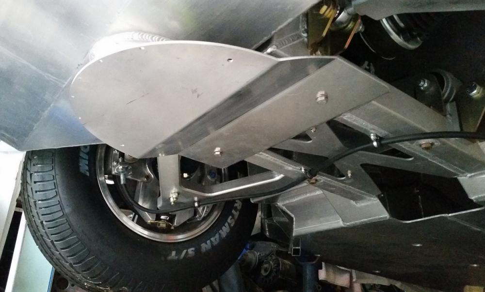

So...today did a test fit of the skid plate for the fuel tank lowest point.
http://www.clubcobra.com/forums/pict...ictureid=19100
I'll remove it now and continue with the fuel filters and the fuel pump. The rock catcher is to be fitted just above the skid plate, and the second filter and the fuel pump are mounted on the bottom face of the trans. tunnel.
Cheers, and stay safe :)
Glen
Sharp eyes might pick up the front end of an Alfa twin cam engine in there somewhere.

I have been wondering, what type of sheetmetal tools do you have ... a shear and a brake?
On the skid plate any thoughts as to some wood or hard rubber, rub blocks?

Umm...no, no panbrake folder or guillo, just my home-made vice, a few clamps, a jigsaw, welder, a bit of brute strength and some cunning :D can make or fix most things.
Have to admit, though, I didn't make the skid plate. That came from PACE, but would have been quite simple to make.
The bottom of the skid plate is at a guess 30mm higher than the bottom of the monocoque, so extra 'skids' on the skid plate aren't really necessary.
