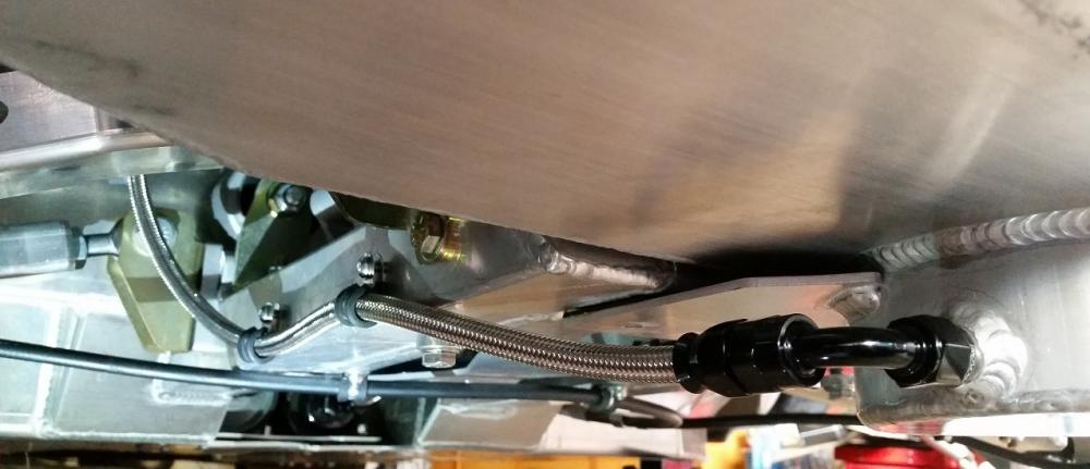

Milestone event after a slow start on the fuel system....
I've never built a fuel system from scratch before, so have not used braided hose and associated fittings previously. Info on ProFlow fittings is hard to find - in fact I could not find anything on building up ProFlow hoses, but can report that my first hose (from tank "out" to rock-catcher filter) is completed to my satisfaction...
Attachment 35098
Glen
**Thanks to Brett (BJ's Snake) for advice :)**
1795 08-19-2020 03:36 AM
Looks good Glen! The one thing I hate the most about working on cars is having to install fittings on stainless steel hose. My finger tips are sore for weeks from tiny punctures from loose wires :CRY: I just do not do it enough to get proficient, or to justify the cost of the special tools. Make sure you wear good gloves.
