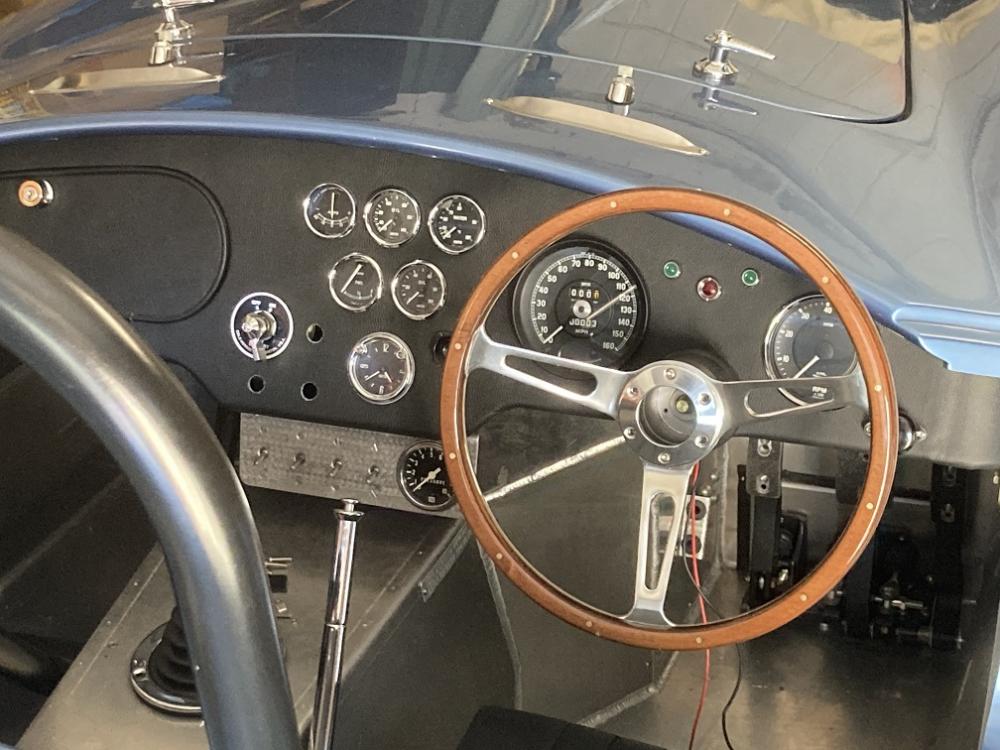

xb-60 04-28-2021 11:27 PM
Also, the dash assembly is looking a little closer to the final result.
http://www.clubcobra.com/forums/pict...ictureid=19583
It's replicating an English car, hence the Smiths gauges.
OK, there's a SW gauge thrown in for good measure :D
Steering wheel will be used to keep some people happy when it's initially on the road; I have a Moto-Lita split-centre wheel to go in its place.
Cheers!
Glen
