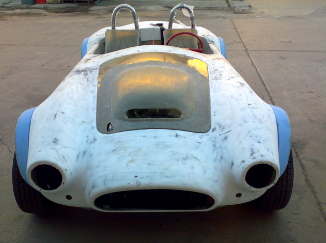

Ozgur_Tan 08-23-2009 08:55 AM
hey
take a look to my monster hood scoop
i'm also thinking shaker hood scoop
regards
ozgur
http://lh5.ggpht.com/_V7qa_5pfXNo/Sp...0820091127.jpg
