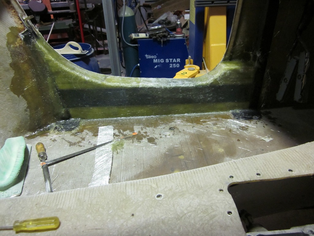

I finally got back to the passengers door sill. I had welded in an extra side intrusion brace in that linked the dash hoop to the door lock pillar. This helps stiffen up the door hinge and lock area and also provide a scaffold to build a door sill on.
I had finished the drivers side but never got back to the passengers side. Well I got stuck in on Saturday and got it all foamed, sanded to shape and then glassed in. Just got to hit it with some filler and a bit of sanding now.

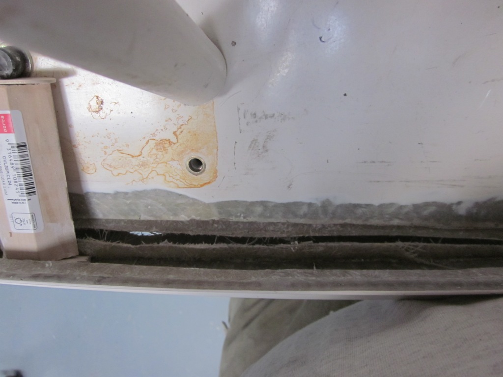

The other job that I've been working on is getting the boot lid to fit nice. Mine was pretty horrible and it looked like the boot lid was just the wrong shape or something as it wouldn't align properly no matter what I did. I decided what it needed was the back of the body pushed out a bit to match the curve of the boot lid.

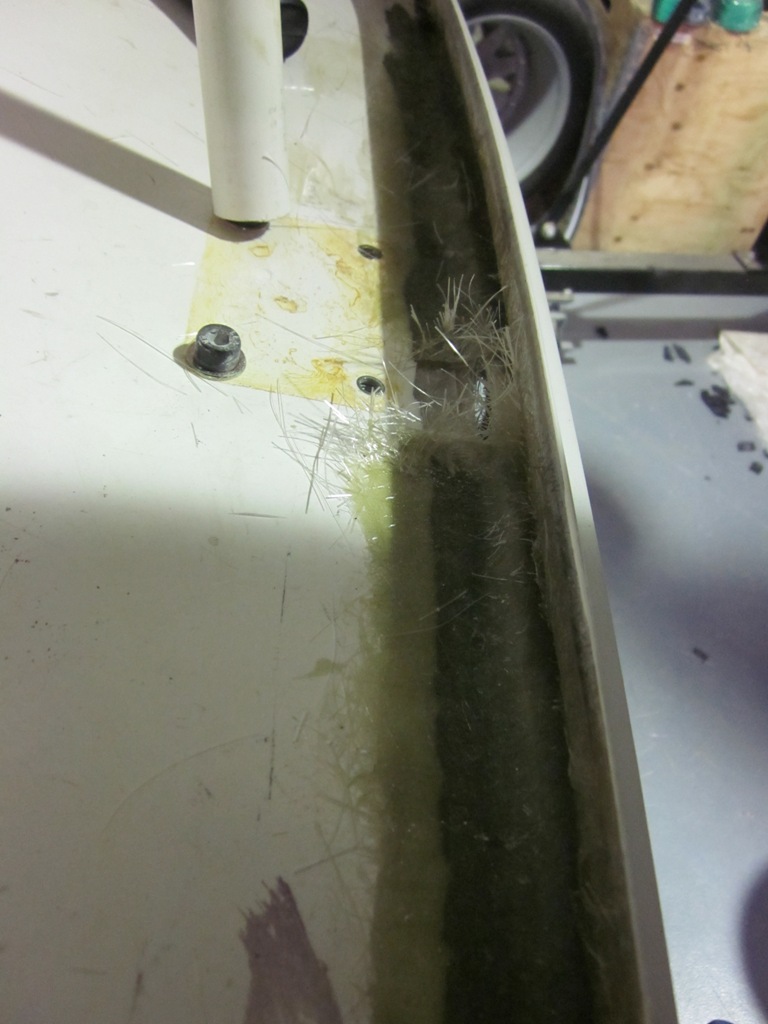

I cut the join between the back edge of the boot floor and the body and flexed it out about 6mm and then glassed it back together.
Once the fiberglass had set I pulled the spacer block out and it now fit's much better. I've got to put another couple of layers of mat in there to make sure it's strong and cover up the gap where the wood block was.
The boot lid is fitting in much better with the body curve more closely matching the lid.

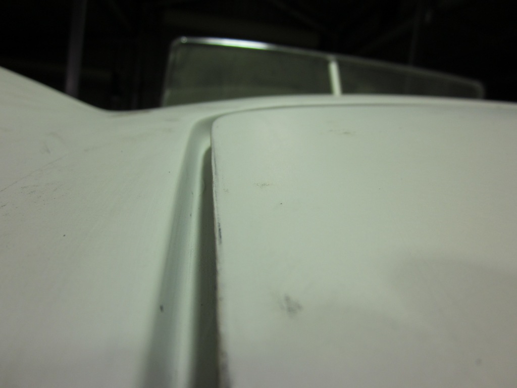

The next thing to sort out is the panel gap around the boot lid. It's huge at the moment.
I'll grind the edge of the boot lid and extend the lip with a strip of fiberglass all around. I can then cut it to more closely fit the boot opening.

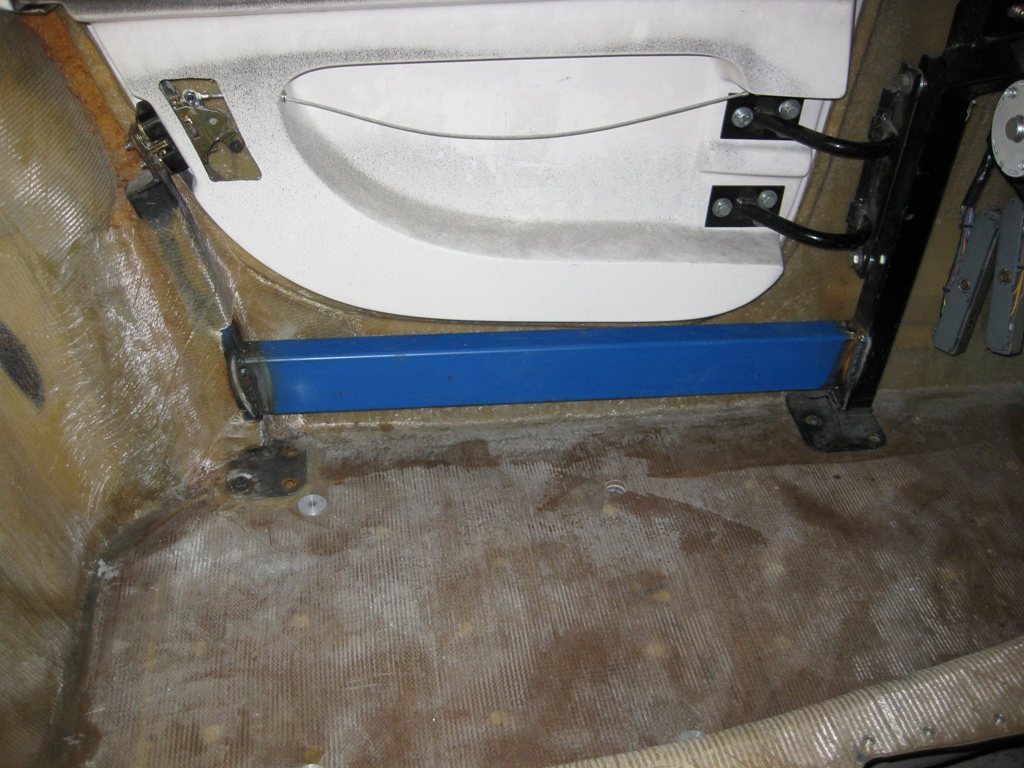

DaveW, I had the same problem with my drivers door which sat about 40mm higher than the body. To fix it my fiberglass guy had to remove the glass encasing the square tube the door striker is bolted to, cut it of, reposition and then re-weld it.
The curved section behind the square tube came nearly flush with the rolled edge of the body. To get the glass to sit back so the carpet wouldn't protrude from the body lip above, my guy cut the glass into 10-15mm vertical strips, pushed the wall into the new position then re-glassed everything up again. He did a brilliant job!

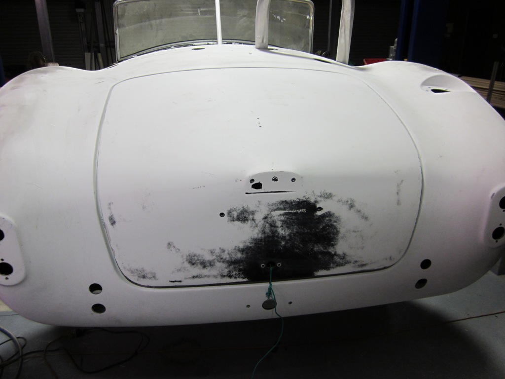

My body shell doesn't fit too bad left to right. Not perfect but good enough for government work.
The drivers door has a fair bit of filler in it. More than I rould like. It's probably 1/8" thick near the bottom. The top edge where it meets the body near the windscreen was really bad. I split the top edge of the door away and wedged it in place then glassed up the gap.
Here's what the drivers door looks like now. You can see where it needed a lot of filler.
This area needed a lot of work. This is where I had to split the door and lift the top front edge up.
The panel gap on the doors was huge too. Lots of filling and sanding and it's a lot closer now.
You can see the line of filler along the bottom edge of the door opening to see how wide the original gap was. It was even worse before I lifted the top of the door.
