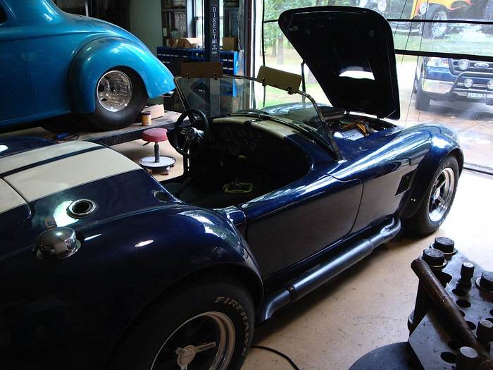

Here's the back up mechanical oil pressure gauge DV installed to give us a some piece of mind, since the electrical one in the dash is waiting on a new sending unit.

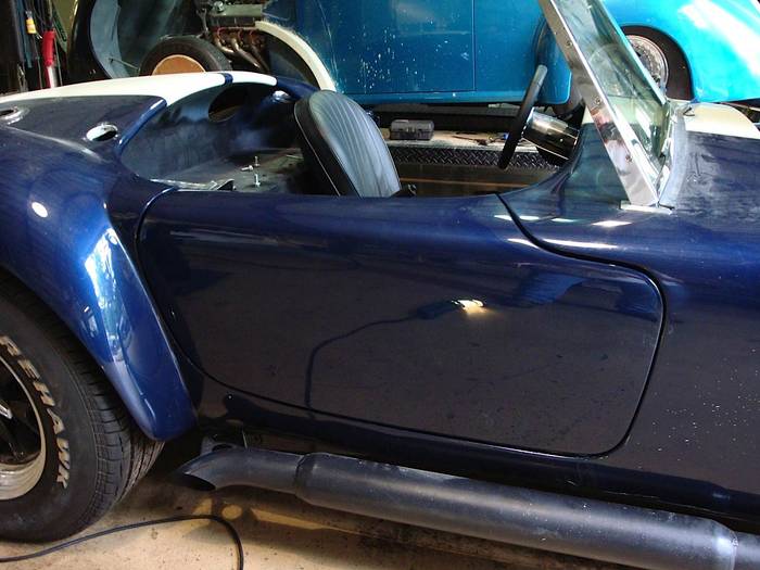

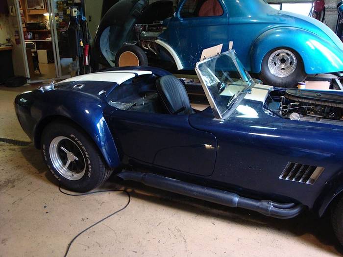

DV hung the passenger door. Check the fit. He hasn't even fine tuned the seams yet, just loosely bolted it in.
Another one of the passenger door.
And one more...
Well we just had to fire her up again!!!

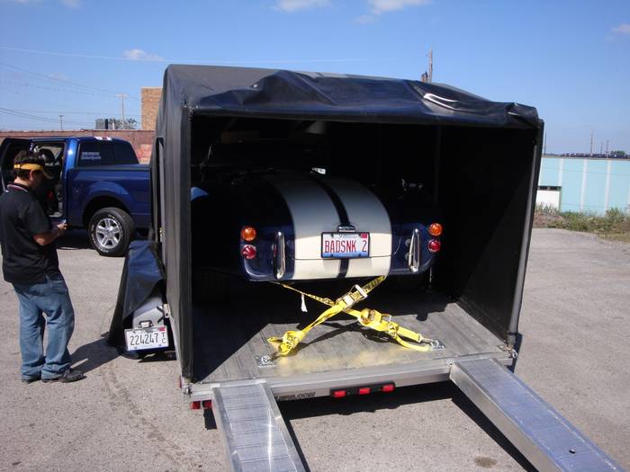

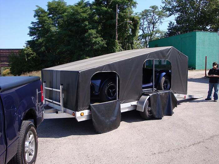

Well the car did get winched onto the trailer and I got it delivered to Bakker's to get the carpet done this week before the car heads for the tranny swap.
here's a couple pics...
At this point not looking good with the driving season coming to an end
