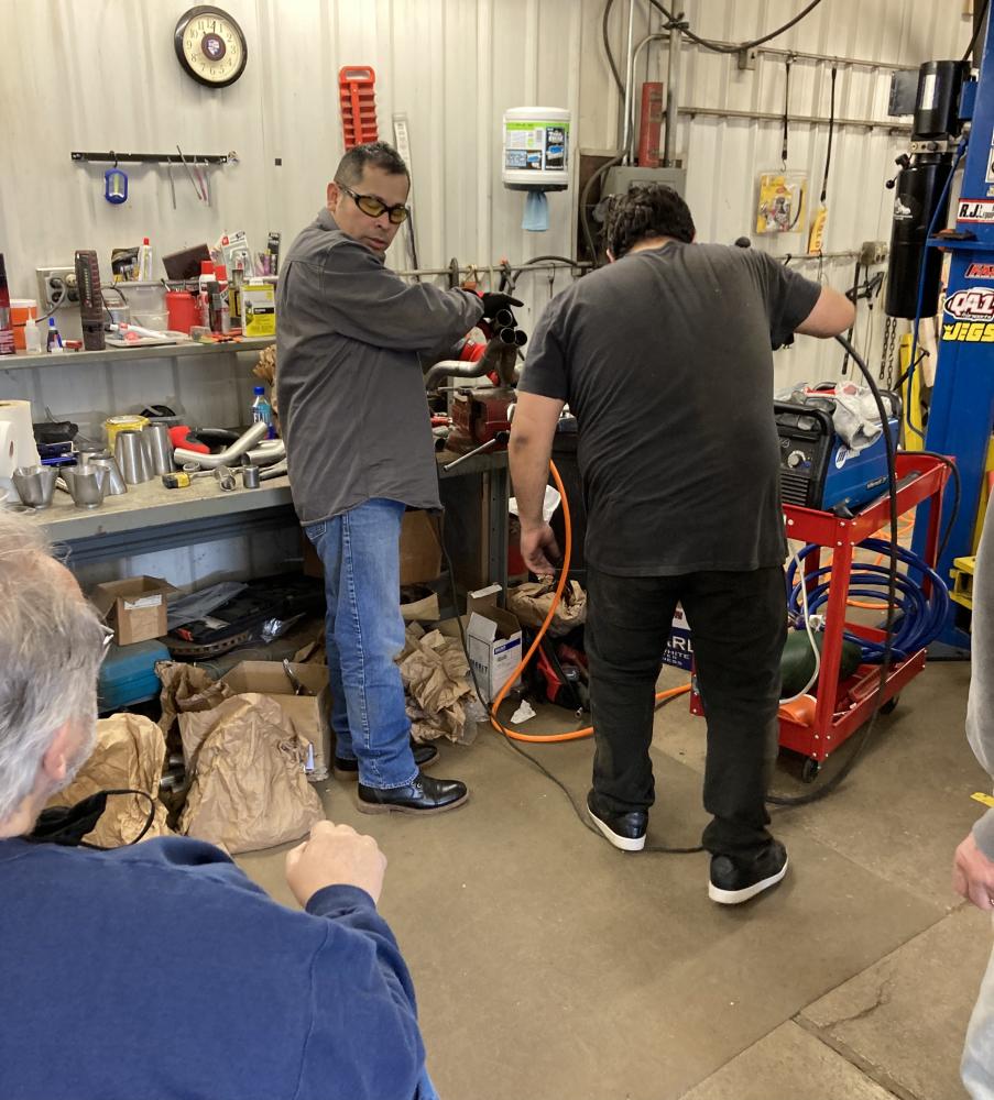

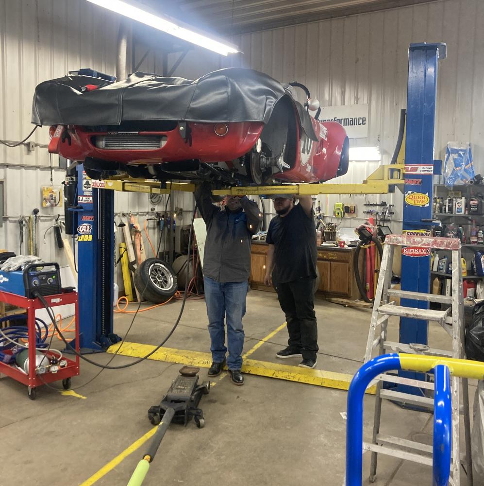

Georgie from Gas-N and his crew came Saturday morning to start the mock-up for the new headers for the race car, these headers will also fit other SPF street cars and FIA's as well, and possibly other cars using the original frame design for the 289's.
What an impressive level of skill to observe. They were quick, efficient and highly talented. They would install a flange on one side, started with the driver's side (which was the most difficult one due to the steering shaft and brake/clutch master cylinders) and started piecing together the tubes.
There was a lot of trial and error, but not too much error, in getting them to fit. They would quickly figure out the angles required, cut a section of tube to fit, test it and tack weld it in place. There was a lot of time spent disconnecting the driver's side motor mount, rolling the engine over and then moving it back, as there is no way to drop the header in from the top on that side and you cannot put it up from the bottom either.
By mid afternoon they had one side done and were moving on to the next.
They will be completing it Sunday morning and then taking the mock-ups back with them to make a new set of headers and a set of side pipes for the car. Truly great people, both personally and professionally. Of course, between having Rick Muck there, Georgie and Rick's friend Mike (who was involved with Shelby's GT350 program) the stories were endless.....Wouldn't have missed it for anything.

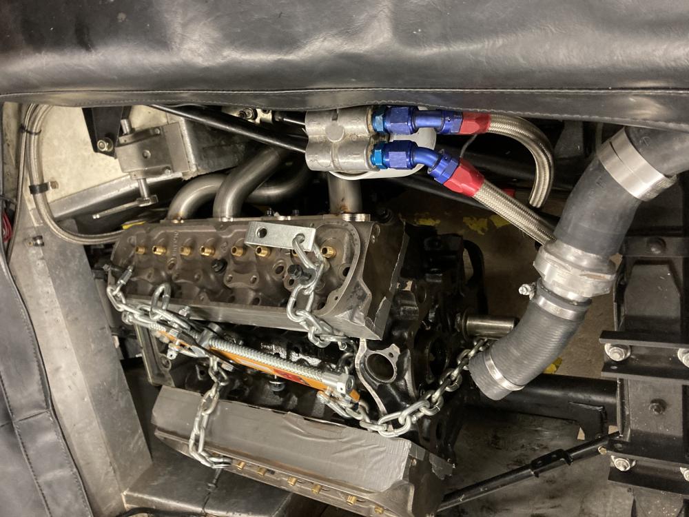

Trying to get everything put back together and ready for a vintage race at Watkins Glen on July 7-11. Georgie sent the test models of the headers to me and they looked good and fit well. The final version will have fewer welds and will look a little more shiny than these, but these will get me on the track and that is all that matters now. It takes awhile in product development to get things to a finish stage and Georgie and his crew have done a very nice job.
The headers are installed. They should flow nicely. Georgie also made me a set of exhaust pipes with a small custom made muffler (straight through flow) to try to keep the noise down to about 100 decibels. Some tracks do not have a noise limit and others do. Besides, I really enjoy being able to hear and open pipes right near your ears can get a little loud.
Will hopefully have everything buttoned up and ready for a dyno tuning session before the race weekend. Going to go to Pitt Race the following week for the Vintage Grand Prix there.
