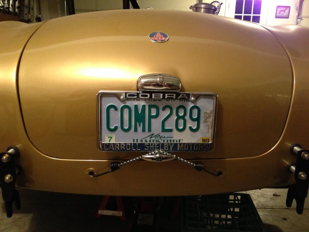

Small steps in suspension are now completed and the progress continues
Drilling painted aluminum - YIKES
Plate with correct frame installed
Now for wiring, fuel tank and hydraulic hook up......................

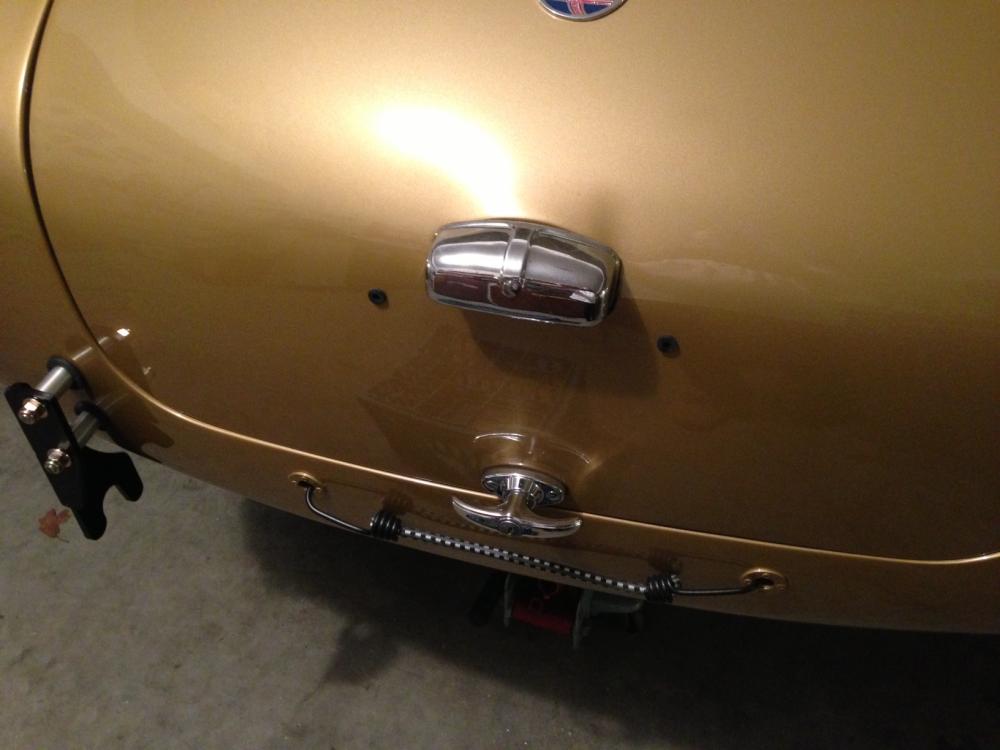

Nice work. You make the protectors for the bungie holes?
ERA FIA 2088
  #589 (permalink)
Old 05-08-2013, 12:33 PM
1985 CCX's Avatar
Location: Manchester, NH
Posts: 19,111
Hyde
Yes, they are aluminum body washers with the rivot holes drilled by hand by eye to keep asymetry.
Trying to post each small step, most of the suspension work is less visual and time consuming. Now I should be back in action...
Original Raydyot going in along with gas tank, final brake lines and radiator hoses....
Fluidyne installed with old Corvette unit to be tried after SU.

Loved the Hertz gold myself..........
Planned Rangoon Red until I saw 3021 after freshen up. Loved it so much it changed my direction on the color.
True story:
The rear plate frame was originally used by Carter Getty on 3047 (Hertz gold 427) as it was sold to Jack Launtz. Jack was not a fan of the frame so it landed on the wall as a "maybe to use someday part" then decades later after his passing landed in mailbox. It spent a year on the Cooper in every day use until I realized it was not a recent repop so I boxed it up to use on this creation. Oddly enough it once again has landed on a Hertz gold Cobra.
Kinda neat...

A thought on the trunk bungee cord. I started with the same set up (with the hooks). They will damage the paint. I tried the 3M clear tape under the hooks and that too was damaged. I ended up with a longer piece that I cut the hooks from
and tied knots in both ends. no scratching and it won't fall off "accidently"

1985 CCX's Avatar
Posts: 19,111
Rick
That is a cool idea!
