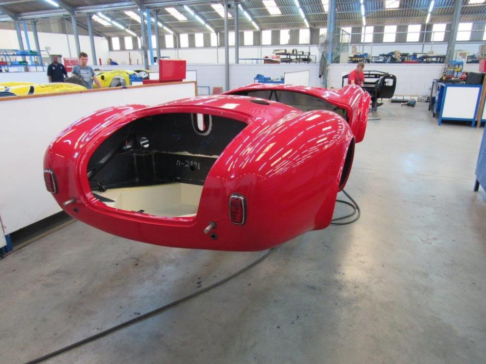

Well, the paint job is finally complete and I must say that it looks great! I cannot wait to have the car back home. Hopefully it will not be much longer before she arrives. You will not miss that car on the track. Hell, it looks fast just sitting there
Hope to have more pictures soon in the coming weeks. Spring is approaching and I have an itch that needs to be itched!
Looks like mine is SPFR0011. I am assuming that means Superformance Riverside Racer.

Yes, it finally makes me feel like I have a car coming. Until now, it has just been a bunch of parts sitting around the house and garage. They did a real nice paint job. Thanks for all the support.
