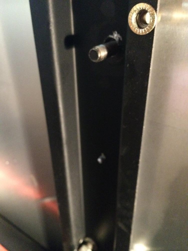

Next the rear panel came out so that i could have access to the frame and roll cage modifications. A little bit of work after removing the screws, but not too bad.
