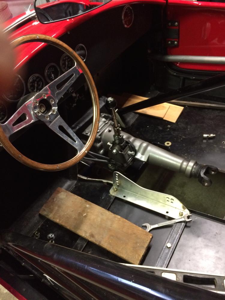

So, had a friend come over today and in 4 hours we installed the engine and transmission, wish that we had more photos , but it was pretty busy work and not much time for photo taking.
Learned a few things, tried to install the engine from the front, and the boom on the hoist was just a little shy, so had to come at it from the side. Also tried to install the engine with the headers in place and that did not work. Too tight. Removed the drivers side header and was able to get the engine mounts in place with some work. Then when it came time to tighten the bolts realized that the header flange was in the way of reaching the bolts, so off came the other header.
The biggest fiasco happened when we we installing the transmission. I had removed the transmission tunnel and we installed the transmission from inside the car. After we had the transmission lined up for install and supported on the transmission mount crossmember, I crawled underneath the car and left my friend in the car to assist from that point. After several attempts we were able to get the input shaft lined up in the clutch and pilot bearing and had maneuvered the transmission forward enough that I could install a couple of bolts into the bell housing. The whole time I am doing bench presses with that top loader. As the night wore on it became heavier and heavier. As I tried to install the top bolt just above the opening for the clutch fork/hydraulic throwout bearing lines, the bolt slipped in my fingers and fell through the opening into the bell housing
Had to remove the transmission and retrieve the bolt. Several attempts and some tired arms later the transmission was finally installed! It is going to be one short driveshaft!
Time for some rest, a much needed beer and get ready for more fun tomorrow.

Good one Jim, Looks the business. Remember diff side has 1310 series U joint which probably does`nt match the slip yoke size on tranny, so a mix and match reqd. ie weld in tube yoke must be 1310
  #211 (permalink)
Old 06-30-2017, 07:33 AM
1795's Avatar
Join Date: Aug 2013
Location: Canandaigua, NY
Posts: 2,504
Thanks Ross, actually the transmission slip yoke is a 1310 size as well, because it is for a 28 spline 289 top loader. The larger yokes are for the 31 spline big blocks.

No pictures today, will have some later tomorrow or Monday. Spent yesterday and today installing the MSD system, leveling the transmission tail with the differential and planning out the transmission support. The car comes with a transmission support that is set up for a Tremec and the support is about 3 inches aft of the transmission support on the tail housing for the Toploader. I have to make a bracket that will bolt to the existing transmission support and then drop down an inch and go forward 3 inches to allow it to be bolted to the poly transmission support bracket on the Toploader.
