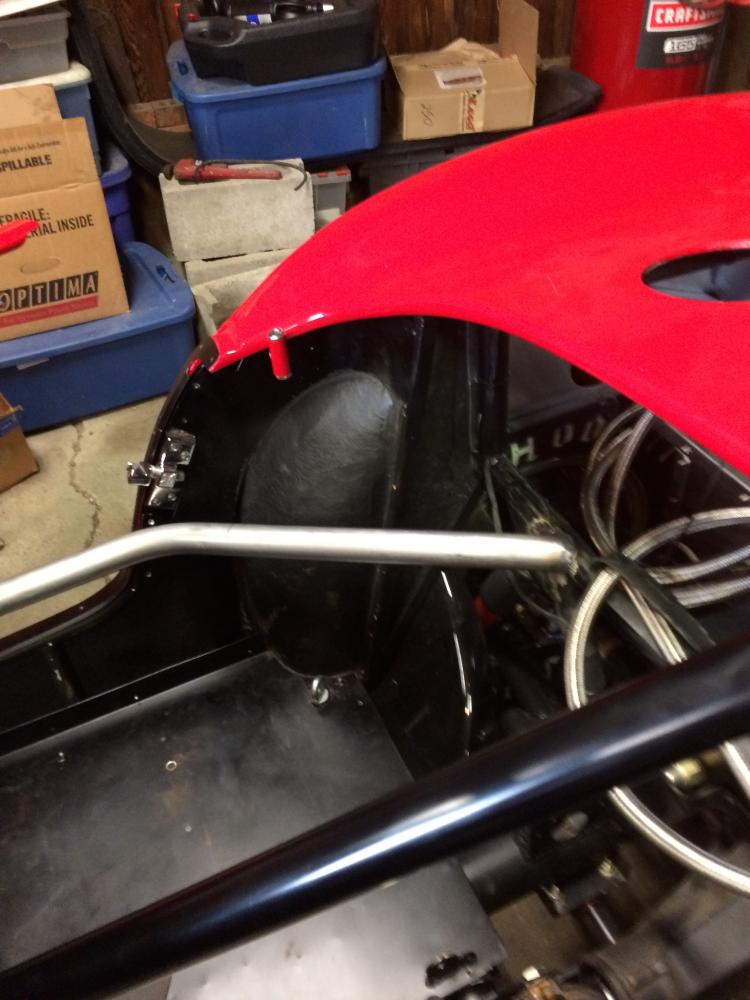

The roll cage has been installed, it is not a full SCCA cage like Morris', as vintage does not require that. However, it is more substantial than vintage requires, for vintage racing side protection is an option. I may decide to supplement the cage in the future. The welder was having a difficult time finding places to weld the side protection to on the front hoop, as the door hinges are in the way. I believe that there is the opportunity to remove the leather strap between the hinges to offer another spot to which to weld. The strap could then be cut and then wrapped around the side support bar.
So here the cage is with the seat in place fresh on the trailer as I picked it up.
This is with the seat removed, in addition to the additional forward brace and side protection, we added a bar in the hoop just below the body for connecting the shoulder harness and a support brace for the seat to get bolted to. We decided on the shoulder harness bar below the body, as opposed to how you see sometimes above the body in the hoop, as above the body would place the shoulder harnesses too high and they would not be effective in a roll over. Shoulder harness straps need to be between 0-20 degrees below the shoulders.
Here are pictures with the seat removed.
Now it on to the engine and transmission install tomorrow.

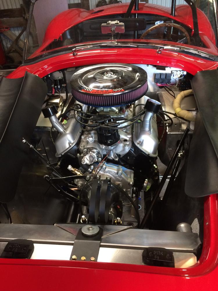

Spent sometime yesterday and this morning working on the car. Installed the driver's side header, a lot less room to work with than on the passenger side. eventually had to loosen the motor mount on the passenger side, remove the motor mount on the drivers side and jack the engine, rotating it towards the passenger side and the header finally went in.
Finished wiring in the MSD 6AL and set the rev limiter.
Also, set the Harrison expansion tank in place, getting ready to plumb in the cooling system.
Going to have to focus on getting the MGB ready for race this weekend. Then back to it. Have a happy Fourth.
